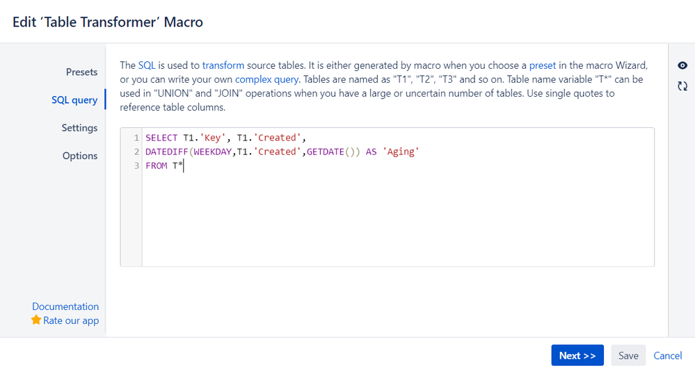

Hi @Bindiya Chacko,
Are we talking about the Table Filter and Charts for Confluence app and its Table Transformer macro?
If this is the case, then here are the screenshots from our test Confluence instance:
SELECT T1.'Key', T1.'Created',
DATEDIFF(WEEKDAY,T1.'Created',GETDATE()) AS 'Aging'
FROM T*

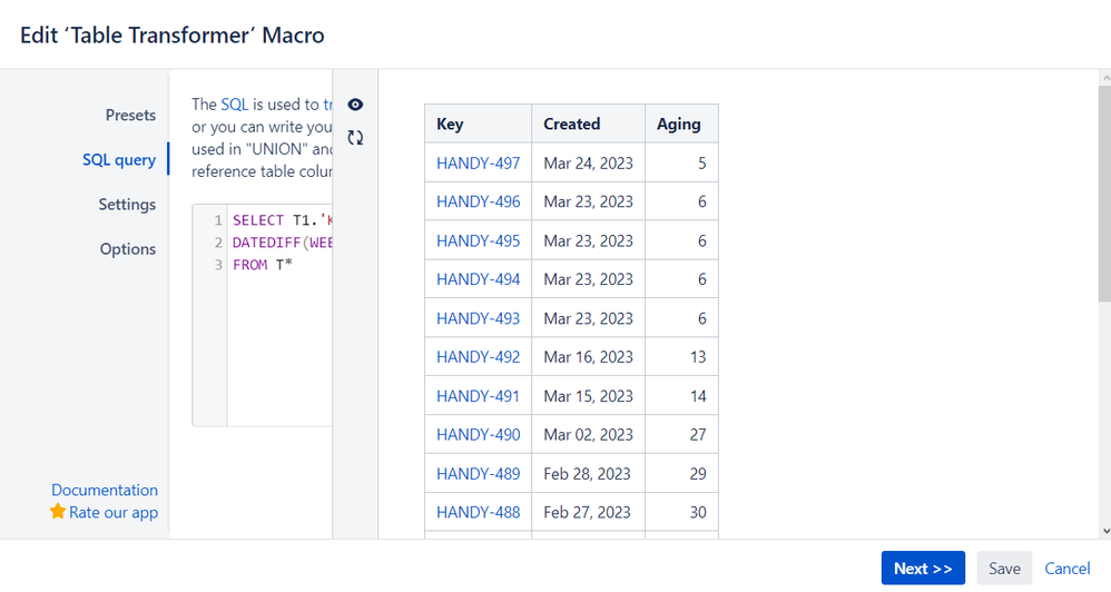

So, everything works fine.
If you get any errors that the functions are not supported, you may update the app. For Server/Data Center the current version is 9.8.1. For Confluence Cloud your add-on is always up-to-date.
If you still need to share some details (source table, macro settings, macro preview, etc.), please refer to our support. The portal is confidential.
If my assumption about the app is wrong, please clarify what add-on and what macro you are trying to use.

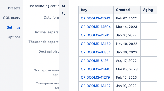

Bindiya Chacko
April 2, 2023
Hi @Katerina Rudkovskaya [Stiltsoft] ,
This is ask is for Table Transformer and the query is not working for me.
Confluence 7.13.2
