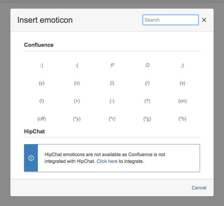

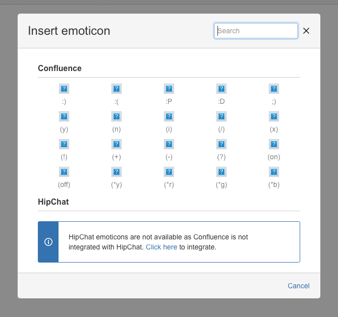

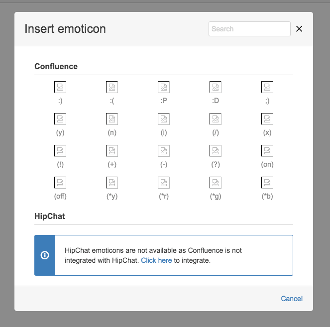

I have a fresh Confluence 6.3 install (official Docker image) and when I edit a page and want to insert new emoticons, I can't see any pictograms/images. Tried it with three browsers - the images are always missing.
Screenshots:
Thanks!

The screenshots you linked indicate that your Confluence instance must be integrated with HipChat to make the emoticons available. Here is the guide for linking the two applications: Use HipChat and Confluence together
StefanN
August 17, 2017
I just want the standard emoticons, nothing else.

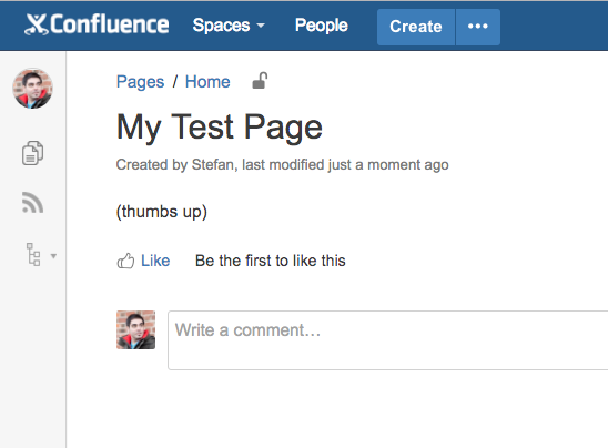

Could you please add your screenshot in the community, because from my working place, I am not allowed to look at the imgur.com-site.
StefanN
August 17, 2017
done
Thomas Schlegel
August 17, 2017
what happens, if you just type (/) on your confluence page?
It should change immediately to:

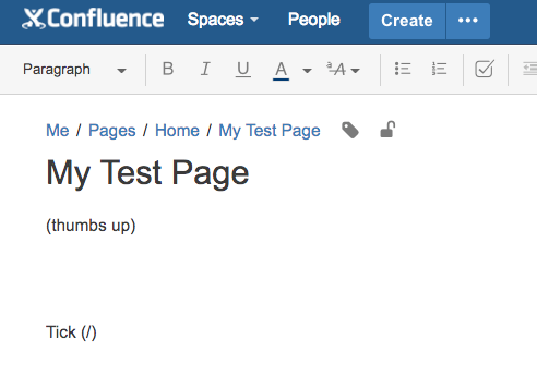

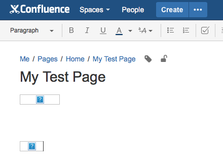

StefanN
August 17, 2017
It doesn't - that's why I have the slight suspicion that something is broken :)
Right after typing it the following happens:
in Chrome:
in Safari:
Thomas Schlegel
August 17, 2017
thanks for the screenshots. It looks like Confluence can't reach the emoji images on its server. Could you please have a look at the url, where your page tries to load the image?

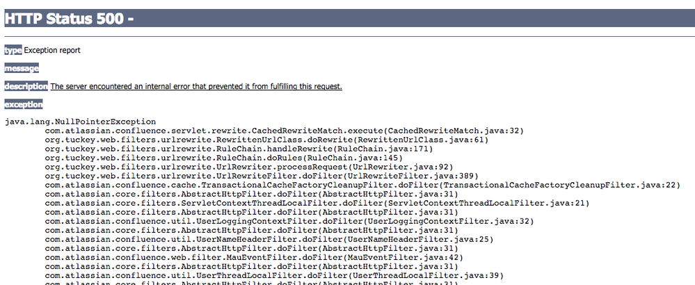

I tried to access a direct image url:
http://myserver/cf/s/en_GB/7202/2b917bf474320363b63231a29396d24a46356543/_/images/icons/emoticons/smile.png
But then I get a Java Nullpointer exception:
As I mentioned, this is a fairly straightforward setup with the default Docker image. I did import some space, but this problem existed even before importing stuff.
