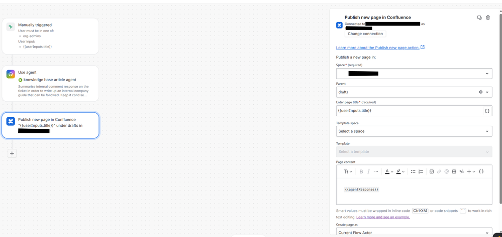

This might be a trivial question, but my attempt to have an automation using a rovo agent to summarise steps on a work item into a KB article guide isn't outputing any of the content into the confluence page.
The steps are:
The page gets created, except there is nothing on the page.
I've reviewed the automation logs, there is output from the agent, but its not coming over to the confluence page.
Seems like something basic im missing?

Hello
Can you provide the details of the Use Agent step, please?
Are you triggering this rule while viewing a Jira issue?
Before the step to create the Confluence can you add a Log action to print the agent response smart value to the rule execution log? Then try executing the rule again and share the audit log output with us.

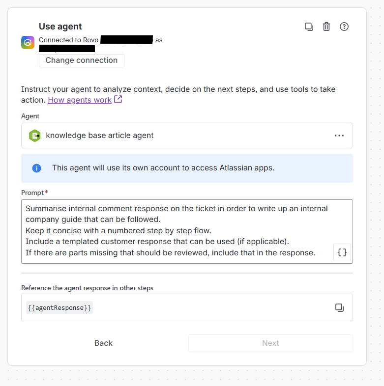

Agent action:
Yes, when viewing a JSM work item

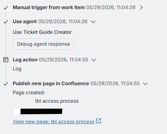

Log action only shows "Log": when attempting to log the {{agentResponse}} response.

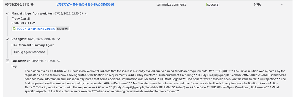

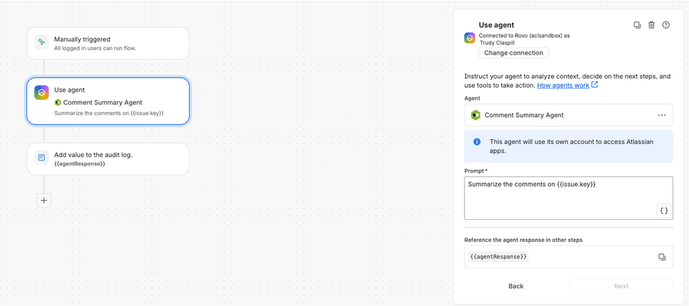

I think that the problem is that your agent doesn't know what issue you want it to reference.
Your prompt says "the ticket". I think if you try replacing that with {{issue.key}} it will then know which ticket to reference and your agent response will not be empty. That is what worked in my simple test.

The log action still only shows 'log', nothing else. the debug agent response shows a good amount of data indicating it's done exactly what i needed, but it's not outputting.

Can you share with us the new version of the prompt? And if you changed the rule in any other way provide a new image showing the rule. And again show the log output.
Also please show the comments of the issue for which you trigger the rule so that we can see that there are Internal comments on the issue.
