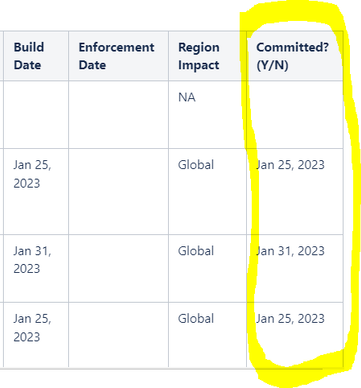

I have a column called 'Build Date'. I created another column called 'Committed (Y/N)'. I want the Committed column to return a value of Yes or No, depending on if there is a build date listed.
What I've tried so far: I thought I could do it by creating a WHEN/THEN/ELSE SQL, but both columns either list the dates in both (like above) or both columns go to YES and NOs. See below

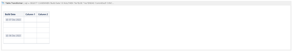

Hi Laurie,
Please modify your CASE WHEN statement as following:
SELECT *,
CASE
WHEN 'Build Date' IS NULL
THEN "No"
ELSE "Yes"
END
AS 'Committed? (Y/N)'
FROM T*
As you can see, everything works as expected.

What are you trying to do with this part of the code, especially with the last entry in bold? It seems that you take your ‘Build Date’ column and show it as 'Committed? (Y/N)'. Thus your “Yes” and “No” from the internal SELECT are overwritten by the dates from the ‘Build Date’ column – the result column has the same name 'Committed? (Y/N)'.
Please check this moment once more.
