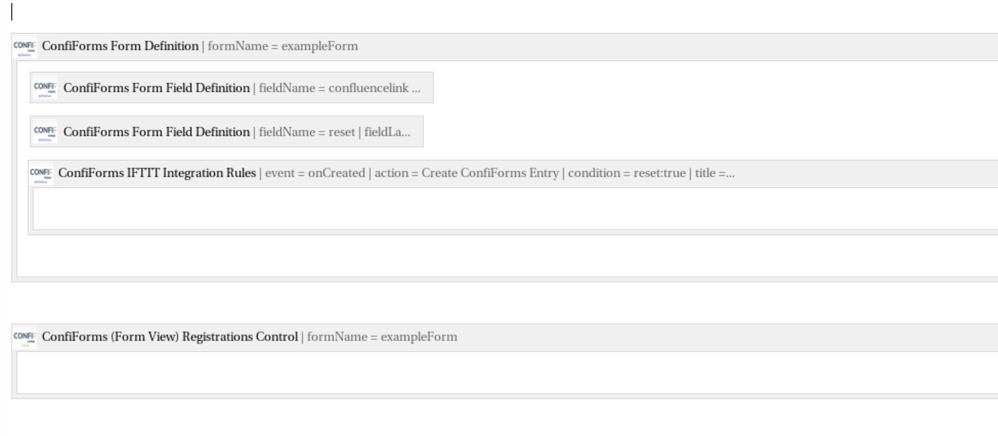

See the simple demo below
Where the "confluencelink" field is of type "link" and I have also a checkbox field for "reset" field
So, when a "reset" field is checked then the link is cleaned up

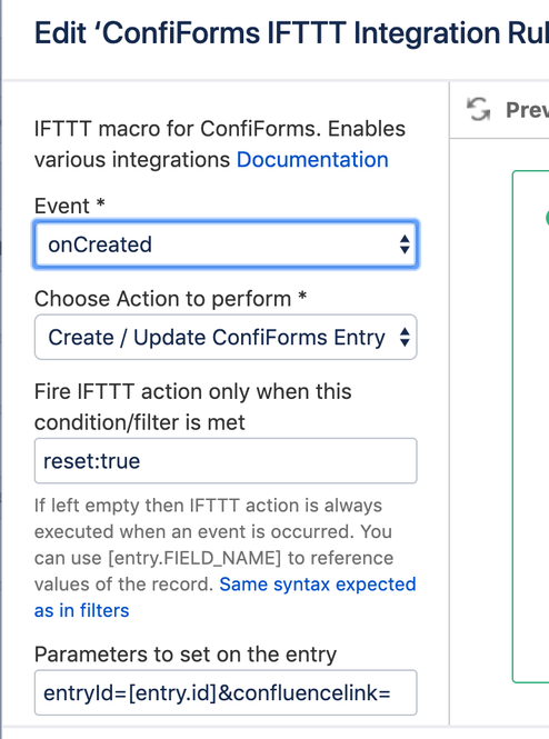

The IFTTT macro configuration is as follows

The type of field you want to "reset" does not matter.
entryId=[entry.id]
tells ConfiForms IFTTT macro to set the parameters on "current" ConfiForms entry. Basically, this is the way to tell ConfiForms action to "Create/Update ConfiForms Entry" to update the entry.
Leaving it out will actually create a new entry / record in ConfiForms form
