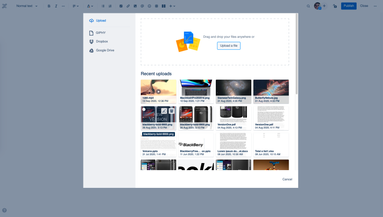

I tried to replicate this behavior but was ultimately unable to. Here is what I see in the “Recent Uploads” section before uploading new pictures:

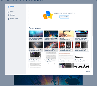

Here is what I see when I upload images to the page and look into the “Recent Uploads” section:

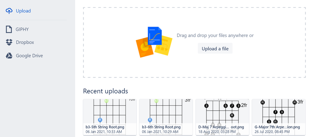

To elaborate, I've just taken a screenshot of what I see on my problematic page after opening the "Files and Images" tool:

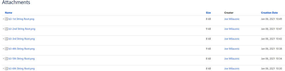

For comparison, here's what is showing up in the attachments list for this page:
Note that four images were uploaded to the page after the most recent of the "Recent Uploads", which is what is causing my confusion.
