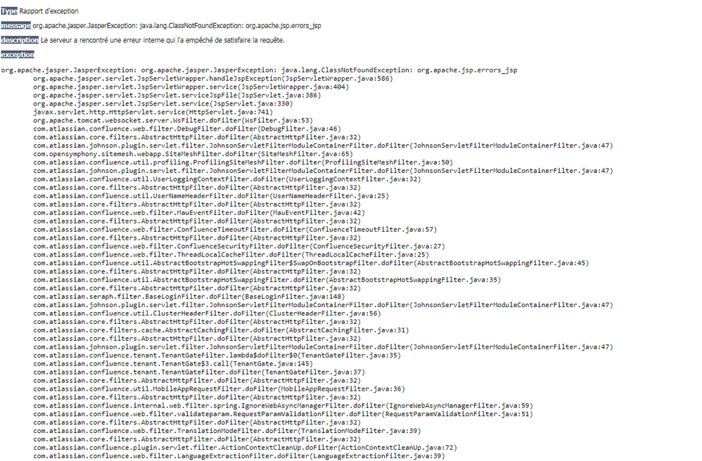

I would like to use an Atlassian Confluence on an Openshift 3.11 platform so I used the docker image "atlassian/confluence-server" and deployed it.
I created a route and tried to access it but I stumble on an error 500 page with the logs displaying an error message : org.apache.jasper.JasperException: java.lang.ClassNotFoundException: org.apache.jsp.errors_jsp
I am pretty new to Confluence and a kind of beginner to Openshift. What is the reason of this error and how is it be possible to fix it and access to Confluence ?

I'd be interested to see the more detailed Confluence server logs, but I suspect you might not have enough disk space.
See Confluence starts up with error message Unable to load class for JSP for further details.
If this doesn't help resolve your issue, then have a look at what errors are being produced in the server logs when you encounter this error in the UI, and share them here.

I tried to fix the issue while assuming it was disk space related but I didn't find any change. It's strange because the server has normally enough disk space to run a Confluence. I even tried to create a persistent storage on the Openshift plateform dedicated to the Confluence pod with enough space but it didn't worked out (perhaps I got it wrong).
Here is the logs I get : https://drive.google.com/file/d/1K5dokkUHFhL0GmGrwKGxJLhc6BVyCVfR/view?usp=sharing
But when I access to the /opt/atlassian/confluence/logs/ directory there is no files in it.

I don't believe that's the location of your Confluence home directory, which is where your logs are located.
You seem to have a large number of permissions errors as well, which you can resolve with the following:
Please try to first correct your directory permissions issues, and then if you're still having issues we can proceed by looking into the Confluence server logs.
