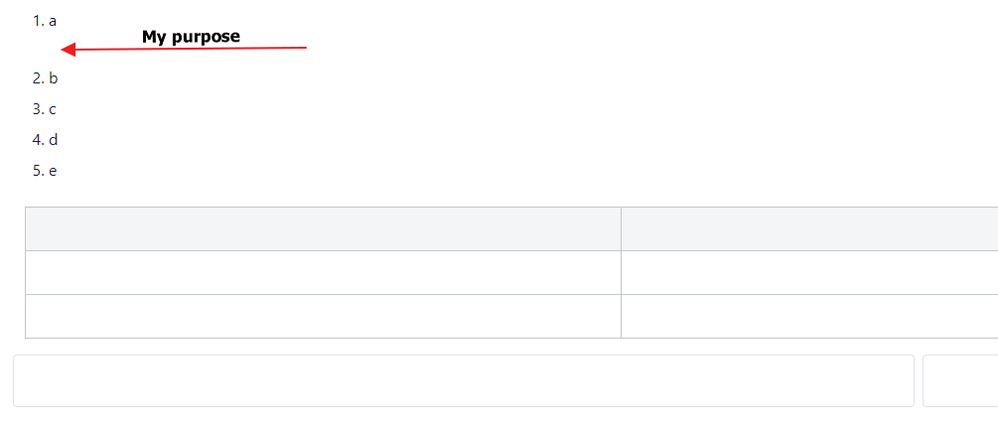

As you see below, any kind of layouts, tables goes to the end of the page. My purpose is to insert them between a and b, but I have no idea. Is it the exceptional situation of my system?

Nic Brough -Adaptavist-
September 12, 2021
Oh, hang on, you're trying to insert a table as a list item.  That's not supported, bullet/numbered lists are expected to be plain simple text - a word, clause or a short sentence.
It's not going "to the end of the page", it's adding the table below the list.
To do a table inside a set of named items, you probably want to stop trying to do it as a list and do them as headings instead.
