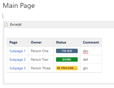

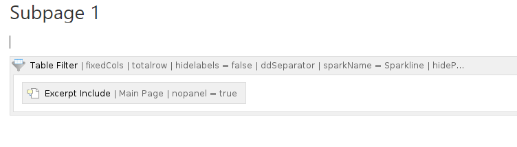

Maybe you could use Excerpt and Excerpt Include macros to display the table on each page. Then wrap the Excerpt Include macro with the Table Filter macro on each page to display only relevant for this page data.
ryder
April 29, 2020
@Andrey Khaneev _StiltSoft_
sounds interesting, do you have an example or more details how to solve this with Table Filter?
April 29, 2020

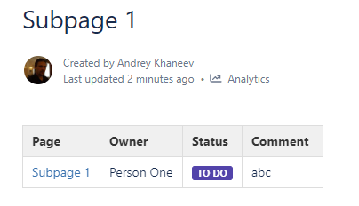

Here are some screenshots:
Table Filter macro filters column Page by Subpage 1 value.

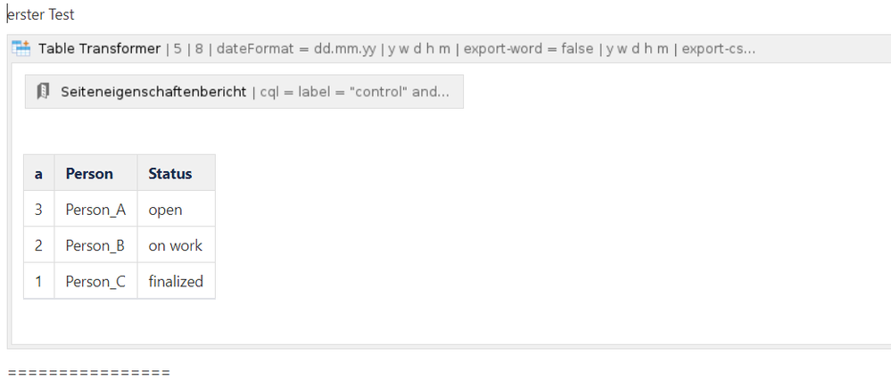

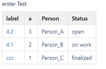

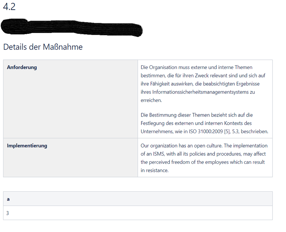

thanks for this hint. That resolved not my issue. But I found another way to solve it.
My way is now like this:
1. I import a the updated space
2. After that I use Bob Swift CLI to give all pages one label
3. Then I replace a version number, which is on each with a small table for using PagePropertyReport. In this table I use insert a Index-Number to have a kind of identical serial number for each page
4. Then I use a Table Transform macro (on a new page) which joins to tables together, one table is the PagePropertyReport, the other table contains one row for every serial number and the additional tables. The join of table Transform makes the a kind of overview table which includes all the necessary data.
See below some screenshots.
Thanks for giving me the right hint.
Regards,
Thorsten
result of the overview:
