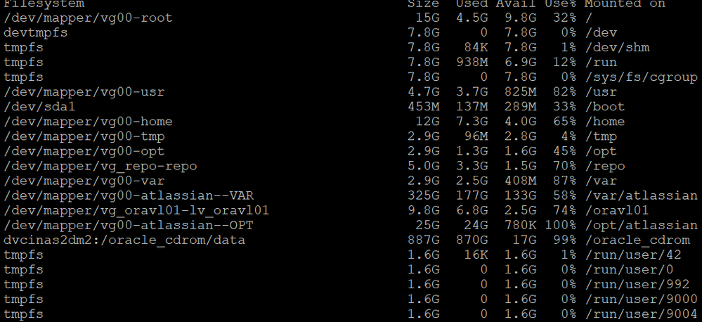

I ran the command and it gives me this output,
anshu02
March 12, 2019
I can see /opt/atlassian is 100% used, do you think this might be causing the issue ?

Yes, that very much will cause issues. The /opt/atlassian directory is commonly used for the Installation Directory. If this is full, Confluence may not work correctly or at all -- This is critical!
A good way to think about the directories is like so:
  • /opt/atlassian -- Tomcat runs the Confluence application code from here and serves up webpages
  • /var/atlassian -- Confluence stores configurations, temp files, attachments, and other stuff here
Commonly, within /opt/atlassian/confluence/.../logs, files can grow overtime. It's possible that the log files in here are too large. You should also check temp directories.
