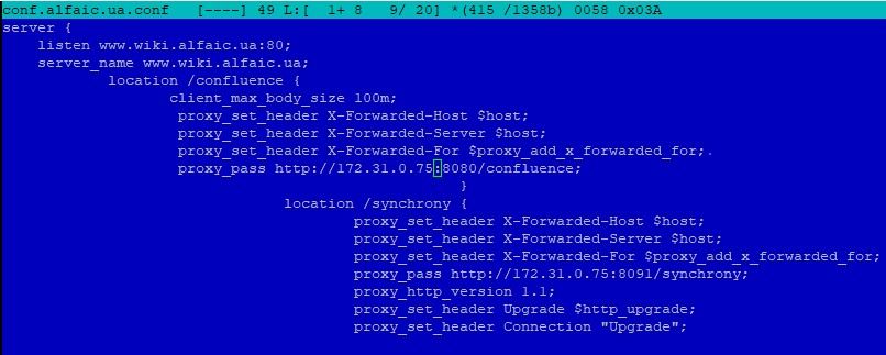

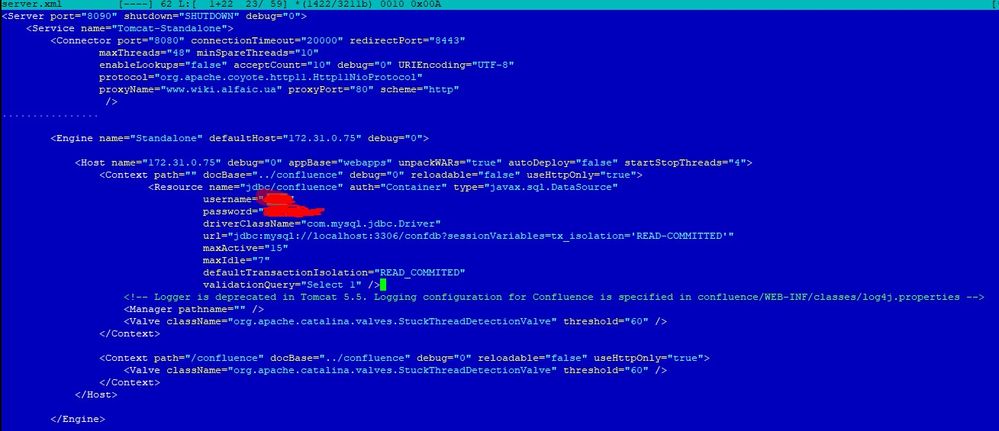

Good day. Got some issues with configuring centos server with nginx + php-fpm. Cant change base URL on server, every time it comes back to using IP as access adress of server.
Add a screenshots of configure files of tomcat and nginx.Screenshot_7.jpgScreenshot_8.jpg

Hi Aleksei,
I understand you are having trouble configuring the base URL to use a proxied URL instead of an IP address and port. Since you are using a Synchrony location in your NGINX configuration, I am assuming you are using a version of Confluence later than 6.0.
I noticed your server.xml is different from the documentation (How to use NGINX to proxy requests for Confluence) in the way the context path is defined. Here is an example of default server.xml "out of the box":

Please try these steps:
  • Back-up your server.xml
  • Create a new server.xml from the default above, so changing only:
  1. Add your MySQL datasource, just as in your posted file, that's the block that starts with <Resource and ends with >
  2. Change the connector port to 8080 in the first connector where the above has 8090
  3. Add your proxyName, proxyPort and scheme to the 8080 connector just as you have in the file you posted
  4. Add the context path "/confluence" to the existing context statement, just under <Host name="IP_address" rather than adding it later on it's own line
I look forward to hearing whether you can successfully configure the Base URL after reviewing the linked documentation and trying the default context path setting.

Aleksei Grishchenko
April 26, 2018
Redirecting is working now. But got another problem, infinity upload of page creating. https://confluence.atlassian.com/confkb/after-upgrading-confluence-you-are-unable-to-create-new-pages-or-spaces-785457379.html?utm_medium=logScan&utm_source=STP , already did all what said in resolution, it didnt help.

Unfortunately, it doesnt help, still infinity window of page creating. Can it be cause of my nginx cfg file have no next strings
location /synchrony {
        proxy_set_header X-Forwarded-Host $host;
        proxy_set_header X-Forwarded-Server $host;
        proxy_set_header X-Forwarded-For $proxy_add_x_forwarded_for;
        proxy_pass http://localhost:8091/synchrony;
        proxy_http_version 1.1;
        proxy_set_header Upgrade $http_upgrade;
        proxy_set_header Connection "Upgrade";
Aleksei Grishchenko
April 27, 2018
even with this part of code doesnt work.
