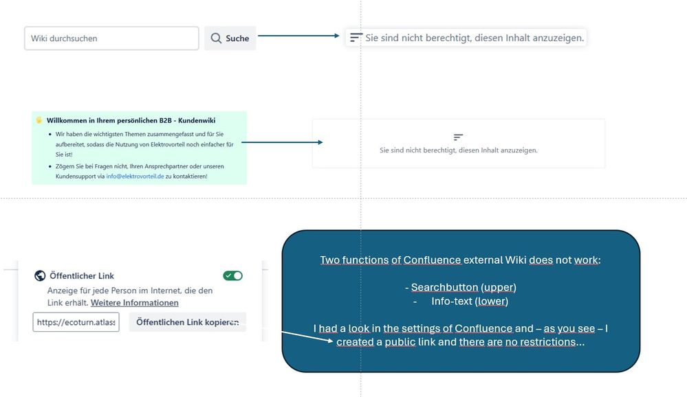

Hello Community!
Two functions of Confluence external Wiki does not work in the view of the external person (Link to B2B-Wiki):
- Searchbutton (upper) // Translation: "You are not allowed to see this content"
-Info-text (lower) // Translation: "You are not allowed to see this content"
I had a look in the settings of Confluence and – as you see – I created a public link and there are no restrictions…
I really don't know how to fix it. Maybe somebody can help :-)

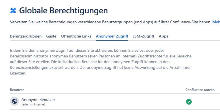

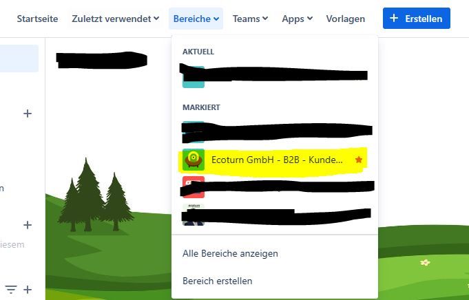

As you see on the picture, I created a full new "Bereich" - area? page? - I am not sure how atlassian calls it in english.ConfluenceProblem2.JPG
I also had a look in the settings for space permissions and I deleted the old link and created a new one...
So as you see - anonymous are allowed to see all of "B2B-Wiki". But still both functions are not working...
