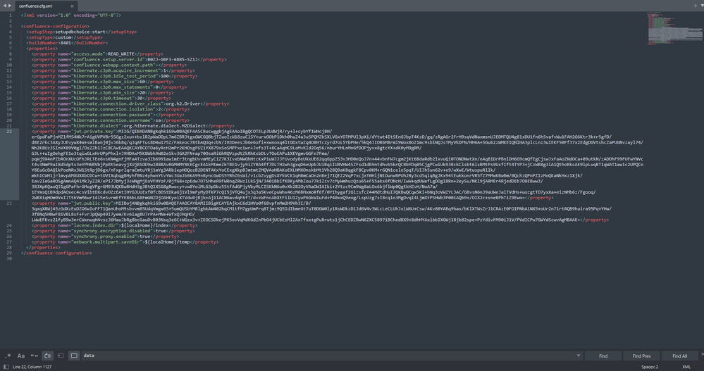

Nick
March 7, 2023
Thanks. Find home dir (it was /var/atlassian/application-data/confluence) and 2 files with name confluence.cfg.xml. I am attaching the one with info (but without database string). It looks like old one "confluence.cfg.xml" is not here and this one is for new state of confluence (installing database). 1.pngFrom this point it looks like my chances to dig up old data going to zero, hah. Last idea maybe - If database was H2 embedded can i get smth out of there?
