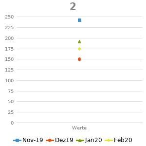

But it only shows this:

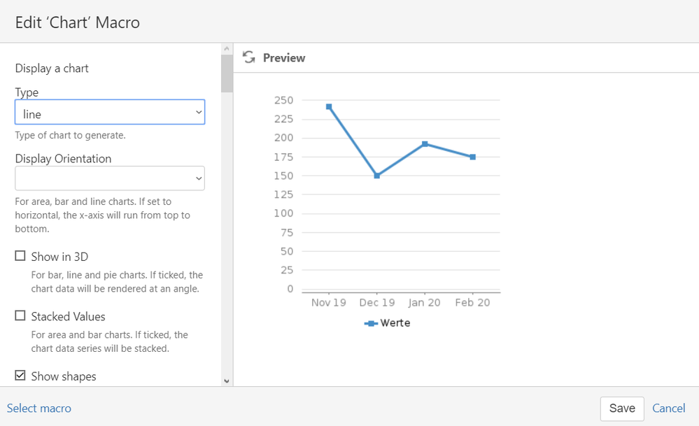

But I want a graph like this:
My chart settings are:
Type: line
Allignement: vertical
Table:blank
Columne: 1,2

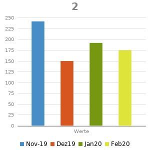

Strange thing, the bar chart is working:

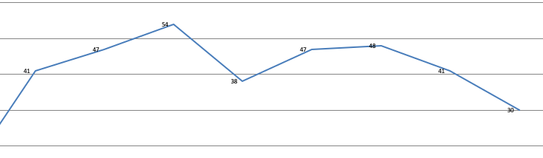

One more thing, I have some tables with filter, that changes the chart:
Is that possible as well in Confluence with the nativ macros?

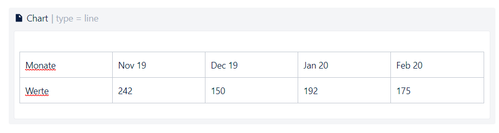

The Chart macro is not very flexible, so you'll need to rearrange your table in a horizontal way.
