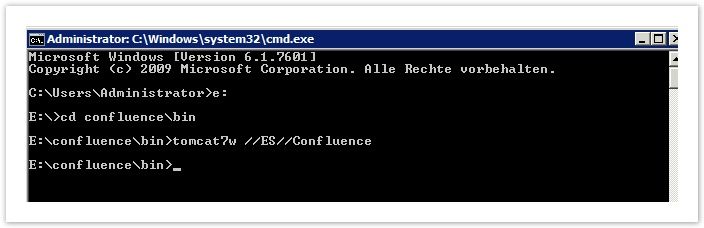

Here is the link to the description of Atlassian.
https://confluence.atlassian.com/doc/start-confluence-automatically-on-windows-as-a-service-172071.html

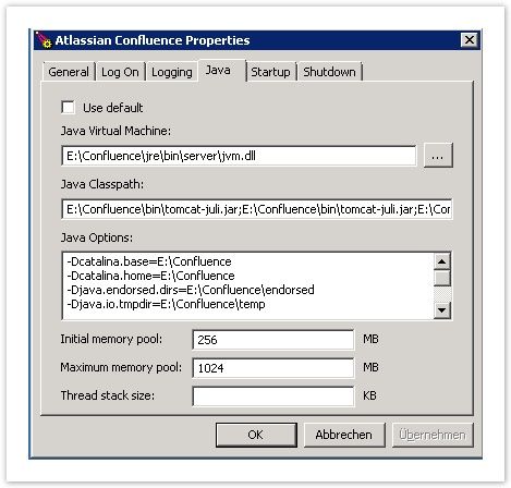

It is important that after creating the service, the path to the JRE is entered correctly.
The command to start the dialog is:
New command is tomcat8w and instead //ES//Confluence   //ES// the name of your serviceJava_Engine_Config.jpg
If the default jre of the confluence is to be used, enter the exact path.
Java Virtual Machine
Java Classpath
