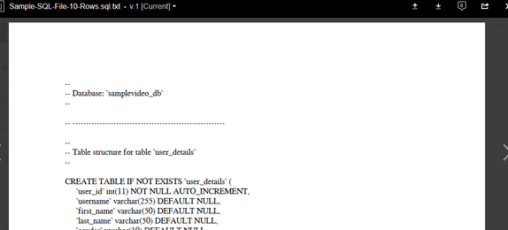

Add a ".txt" extension and upload to confluence. For example if you file is "exampleSQL.sql" then rename to "exampleSQL.sql.txt". When you would like to use the file download and remove "txt".

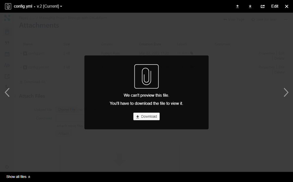

So, in that case you cannot (using standard OOTB functions without any plugin or workaround). Some time ago it was not even possible to preview .txt files... People would like to also have a preview of , js, .java, .ods, .msg, .html .. you would like to have .sql but this is not currently supported (only - JPEG /DOC/PDF/PNG/DOCX/TIFF/PPT/PSD/PPTX/WMF/XLS/EMF/XLSX/ICO/ICNS)
For others users that would like to see the workaround that I propose in action, this is how preview looks in Confluence. I hope it helps someone.

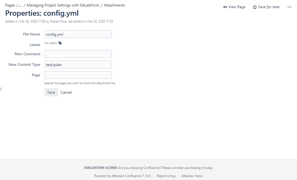

I've found that if you edit the Properties of the attachment and set the mime type to 'text/plain', then via the attachments view (click the paper clip icon at the top above the page title) then when you click on the item it will preview as a text file. Note this still does not make it work via the main page links.

This is not working for me at all. I fully expected this to work the second I saw the "New Content Type" with a MIME specification in it. However, it still says it cannot preview.
I did this on 6 .sql attachments where I had this issue. After a little while (not sure if time is needed), when I click on them from the attachments display, 3 of them display as text, while the other three still say they can't preview. I can't determine anything different between the ones where it worked and those where it did not.
