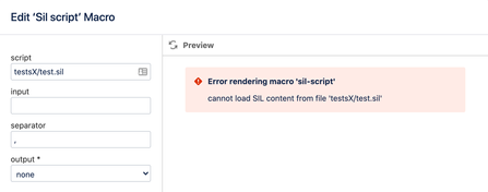

Does anyone use Power Scripts for Confluence?  It looks like the answer to a prayer but I installed it and copied a test script but when I add the SIL "macro" and run it, it just says  "cannot load SIL content from file".  Maybe I haven't configured something correctly but I don't know what.

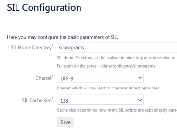

I GOT IT TO WORK!  First, I'm an idiot and my program were in the folders "silprograms/examples" but the program is configured to look in just "silprograms."

Hey @Nancy Bonanno, did you take a look at Scripted macros? I would follow the steps for ScriptMacro so that you can get the hang of it.
If you are getting something like the screenshot below, your subfolder or files' name may be incorrect. Other than that, I don't see any other reason.

Yes!  I'm getting the same error as your attachment.  In what way would my subfolder or file names be wrong?  I just installed and left defaults.  Home directory is "silprograms"... I do have the name of script correct.  Any ideas?

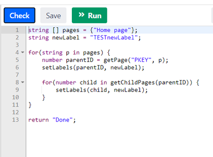

I took your example AddLabelsToChildren and made TestAddLabels.  I'm not sure which variables need to be replaced and with what, though.   Here is what I have at the moment.
Right now, if I run this from the Manager, it returns the word Done but doesn't add any labels.If I add it to a macro on the Home page, it says "Cannot load SIL content from manager."
Questions:   Can I just run this script right here instead of adding it to a macro?  Or do I need to add it to the macro on the Home Page?
If I run it from the Manager, how would it know which Space to add the labels to?
What do I put in the first line for "pages = "...the name of the home page?  The space and the home page?
Do I need to replace PKey with something and if so, what?
