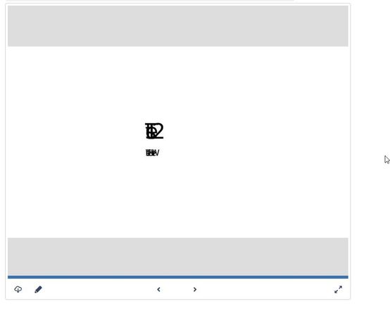

We are hosting a confluence via docker with the lates images (currently 7.2.0) . Somehow after the lates update, the preview pictures from office files like docx or pptx. are not beeing rendered correctly anymore.
For example a simple pptx with one slide.
The preview-thumbnail looks like this :
It kinda looks like a chinese symbol , but i think the letters are just mixed together

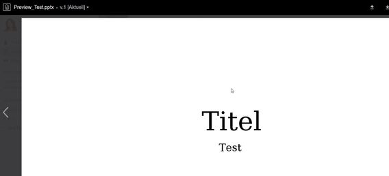

When you open the detailed view it looks ok:
