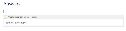

You insert each answer in the Table Excerpt macro (the macros work with any content, not only tables) and set a name to this excerpt.

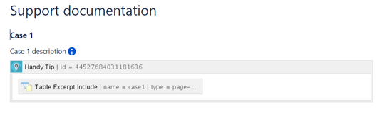

Then you add the Handy Tip macro to your documentation page and place the Table Excerpt Include macro displaying a particular answer inside the tip (please follow the instructions to add a tip). The advantage is that you can search for excerpts on child pages, pages by label, or particular pages.
A page with answers:
A page with documentation:

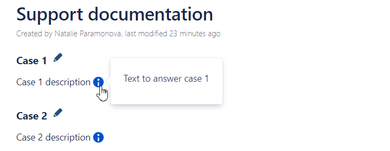

When a user hovers over the answer indicator in the page view mode, he sees the answer:
The mentioned macros are available in the Table Filter and Charts and Handy Macros apps.
