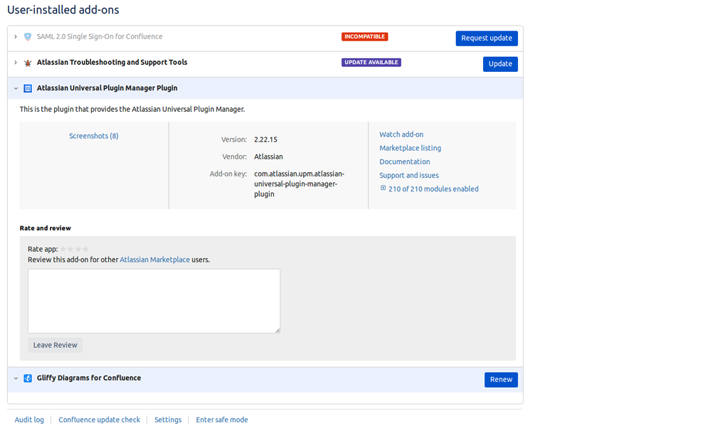

When upgrading Confluence we needed to update some of the Plugins for compatibility. (thanks for the upgrade check, works like a charm)
When I tried this for a specific plugin  I could not see the detail of this plugin when expanding it on the "Manage Addons" page. (See attached screen shot: UPM works, Gliffy Diagramms works not).
While it was no problem updating the plugin by downloading the new version from the Marketplace and uploading it via the "upload add-on" link we do need this detail view as soon as we need to update the license information for this plugin.
So how can we get the details of this plugin visible again?

Hi @Reinhard Kiesswetter,
I've seen this behaviour before, when you have a plugin without a valid license (the Gliffy one seems to be expired). I assume that's a Bug in UPM.
If you click on Setting at the bottom of the Screen and uncheck the "Connect to the Atlassian Marketplace" & do a reload in your Browser.
That should give you the Details on the Gliffy Plugin ... you can then disable it / update the license, check the version, whatever you like to do.
After that you can reenable the connection to the marketplace.

Hi @Christian Reichert (resolution).
You are a wizard, Christian! Disabling the "Connect to Atlassian Marketplace" really revealed the details of the Gliffy plugin. And you were also right, nobody update the license key on time...
Sad thing, re-enabling the option in the settings show the same behavior as before. Maybe I raise a bug for this with Atlassian.

October 1, 2018
once you apply a valid license, it will be fixed. So once the Gliffy Plugin has an valid/uptodate License again, then the problem will go away even with the marketplace connection turned on again.
Turning it off is just a good means to apply that license.
