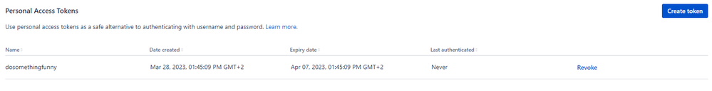

Thanks for the insight. I am wondering where I would set permission for the PAT. As far as I understand from the documentation, the PAT should have the same permission as my user. When creating a PAT I cannot select any permissions, just create one. Also it seems that Confluence is unaware of the fact that I did use my PAT. I just discovered that in my settings dialog it says: "Last authenticated: Never" in regard to this PAT. So apparently curl -H "Authorization: Bearer <yourToken>" did not go through, which would explain the API answering 200 OK but with no data, as it did not authorize.

it seems that Confluence is not recognizing the use of the PAT, as indicated by the "Last authenticated: Never" message in your settings.
