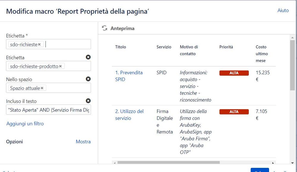

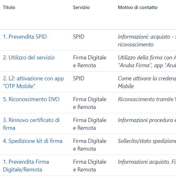

I have a problem with the macro "page properties report" and I am hoping to find an explanation and some help.
Basically what we found is that the macro "page properties report" fishes data from outside the macro "page properties" in the page it recalls, and we were wondering why this was the case.
What we figured so far is that the problem is triggered by the "including text" filter, as the macro will then go and recall any page (in the selected space) that contains that text even if that text is located outside the page properties macro.
In the pictures you can see the table showing two different items in the Servizio column (firma and SPID) and the parameters we had set in order to show only one type of service per table. the word "SPID" is not in the page properties table but the page properties report table recalls it anyway.
I hope the issue is clear, could anyone please share how they solved it? Ideally we don't want to use labels to solve the matter, it would get very crowded and it is a bit difficult already to sort throw different kinds of labels (also, these pages are accessed and edited by a lot of people so it is realistic to expect mistakes)

Hello @Katerina Kovriga _Stiltsoft_ , thank you so much for the response!
Unfortunately the available filters are not suited to what we need as we need one table per "service" and there is no filter that allows us to do that without adding the text in.
I am definitely going to report the issue to the Atlassian support.
