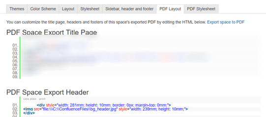

Hi Patrick.
As you can see on this picture:
I added the code in PDF Layout in the Header section as described under you provided link under "Adding Images to Headers and Footers". This works in 6.6.0 but on in 6.10.0.
Best regards
Try following the instructions on the previous link which are to upload the image onto your instance and link from there. Maybe they changed this for 6.10.
