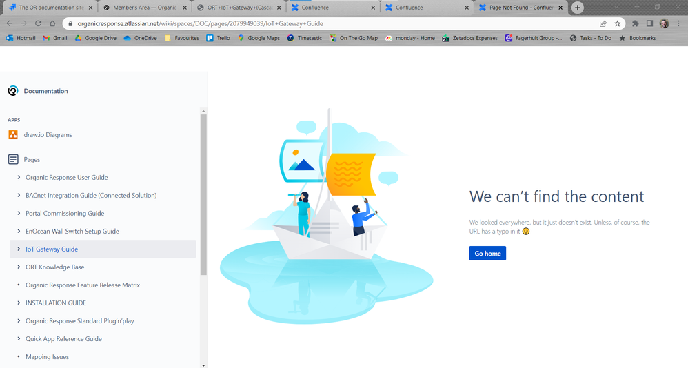

Since last week, all our customers are not able to access our public documentation space on confluence although we haven’t changed any settings. what could be the issue?CF593A90-04B8-442C-8CD2-3728194B1BD9.png

Hi Brant,
Thank you for your prompt answer,
Global anonymous access is not turned off and public links is disabled.
Got more information from our customers, most of them can access our documentation space using Edge browser but not Chrome
any Idea?
Thanks
Abdallah

Hi @[deleted]
We would like to confirm a few things in order to confirm if the issue still persists:
  • Make sure that you are running the latest version of the browser, so it will be compatible with the Cloud environment
  • Manually disable the browser extensions to avoid any of them possibly blocking the content to be loaded.
  • Run the browser in incognito mode to see if this is affected by stored information on the browser.
  • Try on a different browser;
If the issue still persists, would you mind confirming the following, since I could confirm the page/space DOC is open to anonymous and I can access it successfully:
  • Users are logged in when they get the error?
  • Users logged in, are customer accounts (portal account/knowledge base) or agents (product licensed)?
  • Are the users getting these errors if they access them anonymously? (must be not logged in)
The reason I'm asking you this is because I can't see it on your screenshot if it is an anonymous user accessing, a logged-in user, or if it could be a customer portal account only.
We have an ongoing bug, that affects portal-only accounts only:
So in case users are able to access the pages in an incognito window, without logging in, but are portal customer accounts and cannot see the page even though it is open to anonymous, while logged in with the portal accounts, they are being affected by the bug.
Please let me know how the test goes and the additional information. :)

May 2, 2023
Hi Jessica,
It seems that our customers can access the documentation in incongnito mode and when they are logged out of service desk. It seems we are affected with that bug where authenticated customer account can't access the anonymous documentation.
Br,
Ahsan
