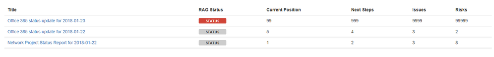

I have created weekly status reports using tables and page properties macros. I also have a page which shows all project reports using the page properties report macro. All good so far but now I only want to show the last report for each project.  Any suggestions?

How does your report table looks like?
I think it is possible to filter this table with Table Filter macro.
Chris McNicholas
January 23, 2018
Andrey Khaneev _StiltSoft_
January 23, 2018
Unfortunately, I don't see a good solution here: you'll need to set filter to hide exact pages in the table and update the filter each time you create new pages.
But if you could guarantee that new pages are created periodically (fro example, each week) for all project types, then it will be possible to filter by created date.
