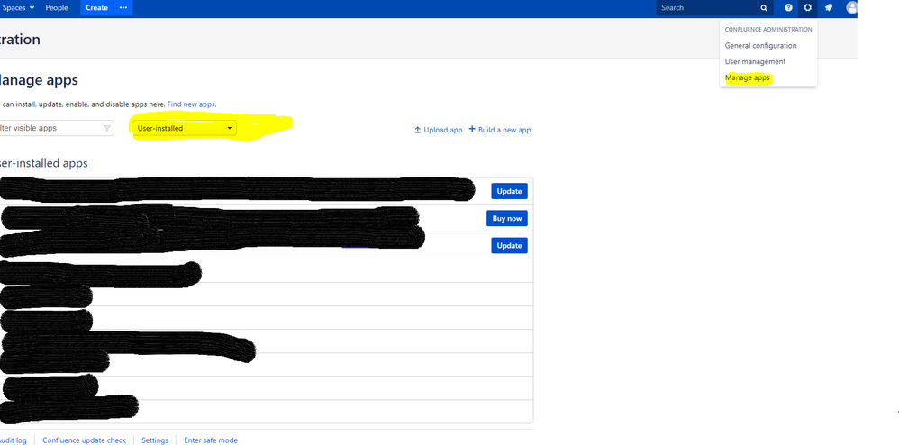

Hi @EL Motasim Gumaa, thank you for your help!  I just checked and these are the only user-installed apps I have:
  • Atlassian Troubleshooting and Support Tools
  • Atlassian Universal Plugin Manager Plugin
  • Cloud Migration Assistant for Confluence
  • (Image: https://i.imgur.com/wP1QQws.png)
EL Motasim Gumaa
January 16, 2019
Hi @Nathan Wailes
 Then it's only a configuration(server.xml & apache conf) problem. So, you will have to import the certificate to the keystore and use port 443 in your Apache config as @Alexandru Luchian Constantinescu described.
