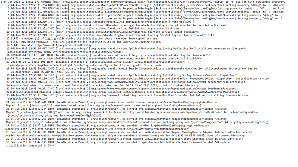

Hi Thomas,
Oracle setup is fine and after up-gradation from 5.8.18 to 6.2.1 we where able to access the Confluence for almost more than a year.
Unexpectedly confluence system went down and after restart we are not able to access confluence and getting error .
I have attached screen shot of the atlassian-confluence.log and catalina logs.
Please do the needful.

    at com.atlassian.confluence.schedule.listeners.ScheduledJobsListener.jobToBeExecuted(ScheduledJobsListener.java:173)
    at com.atlassian.confluence.schedule.listeners.ScheduledJobsListener.lambda$jobToBeExecuted$2(ScheduledJobsListener.java:100)
    at com.atlassian.confluence.schedule.listeners.ScheduledJobsListener$1.doInTransactionWithoutResult(ScheduledJobsListener.java:165)
    at org.springframework.transaction.support.TransactionCallbackWithoutResult.doInTransaction(TransactionCallbackWithoutResult.java:34)
    at org.springframework.transaction.support.TransactionTemplate.execute(TransactionTemplate.java:133)
    at com.atlassian.confluence.schedule.listeners.ScheduledJobsListener.executeInTransaction(ScheduledJobsListener.java:162)
    at com.atlassian.confluence.schedule.listeners.ScheduledJobsListener.executeInTransactionAndHandleExceptions(ScheduledJobsListener.java:139)
    at com.atlassian.confluence.schedule.listeners.ScheduledJobsListener.jobToBeExecuted(ScheduledJobsListener.java:97)
    at com.atlassian.confluence.impl.schedule.caesium.JobRunnerWrapper.runJob(JobRunnerWrapper.java:81)
    at com.atlassian.scheduler.core.JobLauncher.runJob(JobLauncher.java:153)
    at com.atlassian.scheduler.core.JobLauncher.launchAndBuildResponse(JobLauncher.java:118)
    at com.atlassian.scheduler.core.JobLauncher.launch(JobLauncher.java:97)
    at com.atlassian.scheduler.caesium.impl.CaesiumSchedulerService.launchJob(CaesiumSchedulerService.java:443)
    at com.atlassian.scheduler.caesium.impl.CaesiumSchedulerService.executeLocalJob(CaesiumSchedulerService.java:410)
    at com.atlassian.scheduler.caesium.impl.CaesiumSchedulerService.executeQueuedJob(CaesiumSchedulerService.java:388)
    at com.atlassian.scheduler.caesium.impl.CaesiumSchedulerService$1.consume(CaesiumSchedulerService.java:285)
    at com.atlassian.scheduler.caesium.impl.CaesiumSchedulerService$1.consume(CaesiumSchedulerService.java:282)
    at com.atlassian.scheduler.caesium.impl.SchedulerQueueWorker.executeJob(SchedulerQueueWorker.java:65)
    at com.atlassian.scheduler.caesium.impl.SchedulerQueueWorker.executeNextJob(SchedulerQueueWorker.java:59)
    at com.atlassian.scheduler.caesium.impl.SchedulerQueueWorker.run(SchedulerQueueWorker.java:34)
    at java.lang.Thread.run(Thread.java:748)
2018-06-04 12:54:37,630 WARN [Caesium-1-2] [confluence.impl.hibernate.ConfluenceHibernateTransactionManager] doRollback Performing rollback. Transactions:
  ->[null]: PROPAGATION_REQUIRED,ISOLATION_DEFAULT (Session #1639428673)
2018-06-04 12:54:37,637 ERROR [Caesium-1-2] [impl.schedule.caesium.JobRunnerWrapper] runJob Scheduled job LaasPerformanceLoggingJob#LaasPerformanceLoggingJob jobToBeExecuted failed to run
org.springframework.transaction.UnexpectedRollbackException: Transaction rolled back because it has been marked as rollback-only
2018-06-04 12:54:37,648 WARN [Caesium-1-2] [confluence.impl.hibernate.ConfluenceHibernateTransactionManager] doRollback Performing rollback. Transactions:
  ->[null]: PROPAGATION_REQUIRED,ISOLATION_DEFAULT (Session #1252186397)
2018-06-04 12:54:37,649 ERROR [Caesium-1-2] [impl.schedule.caesium.JobRunnerWrapper] runJob Scheduled job LaasPerformanceLoggingJob#LaasPerformanceLoggingJob jobWasExecuted failed to run
org.springframework.orm.hibernate5.HibernateJdbcException: JDBC exception on Hibernate data access:
SQLException for SQL [select confluence0_.BANDANAID as BANDANAID1_7_, confluence0_.BANDANACONTEXT as BANDANACONTEXT2_7_, confluence0_.BANDANAKEY as BANDANAKEY3_7_, confluence0_.BANDANAVALUE
as BANDANAVALUE4_7_ from BANDANA confluence0_ where confluence0_.BANDANACONTEXT=? and confluence0_.BANDANAKEY=?]; SQL state [72000]; error code [1555]; could not execute query;
nested exception is org.hibernate.exception.GenericJDBCException: could not execute query
