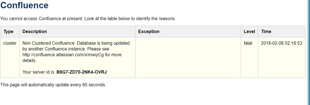

Hi,
I have some errors, can some one help me about this.. thank you!.

Nic Brough -Adaptavist-
May 28, 2018
There are two Confluences trying to access the data, which won't work.
If it is a spurious record due to one Confluence crashing, a simple restart of both the database and Confluence will fix it.
I usually see this when someone has cloned a production system to use as a test, and they've forgotton to change the clone to point to a test database.
Generally, the database can tell you about incoming connections, so I'd start there.
February 8, 2018
There is an active Confluence pointed at your database, so it is running it.
The Confluence showing this error message is a second (or third, or more) one that is trying to use that database.  This cannot be done - the first Confluence running puts a lock on the data to prevent any further instances of Confluence from corrupting the data.
You need to use the first Confluence, and shut down the second.
