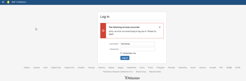

No one able to login to confluence server!
Princely Benedict
August 16, 2018
Hi there,
Thanks in advance. We have one Jira server and Confluence 6.6 server on different Ubuntu box. As well we use Mysql database on defferent Ubuntu box. Now now one cannot log in to confluence server. need some help.

I tried start the service manually. No luck. Password is correct, Tried different users and password. Did not work.
I think the confluence server is not talking to Jira server. I you assist me where is the configuration parameter on confluence server which is point to jira server to authenticate. I mean which file in confluence then it will fix the problem.

I have tried the recovery_admin login: i got the same login error

AnnWorley
August 16, 2018
The URL Confluence uses to reach Jira for user management is stored in the database rather than the file system.
To update the configuration:
  1. Follow this article to regain access to the Confluence instance: Restore Passwords To Recover Admin User Rights
  2. Go to Confluence Admin>User Directories and edit the Jira User directory
  3. Update the Jira URL, save changes.
Test logging in via an account managed by Jira.

Hi Princely,
Do you know if Jira has been set up to manage users for Confluence? If so, an inability to reach Jira from Confluence could prevent logging into Confluence.
Your other post linked an article related to Crowd, was that in error?
To learn more about why users cannot log into Confluence, please check the log at:
<confluence_home>/logs/atlassian-confluence.log
Note: The <confluence_home> directory is the path defined in the following file: <confluence_install>/confluence/WEB-INF/classes/confluence-init.properties
Please search for the user name that was used to test the login, and pay attention to entries that start with ERROR. I look forward to hearing what the logs reveal.
Thanks,
Ann
