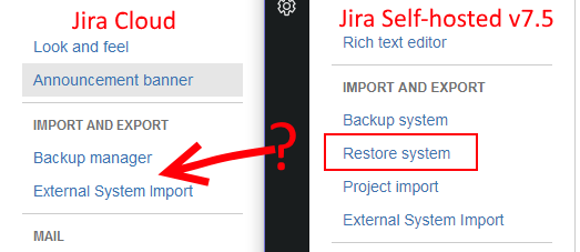

Hello,
We want to copy data from our Self-hosted JIRA to Cloud. We just started using Jira Cloud and want to import/migrate data from Self-hosted. But in Jira Cloud, there is no section “Restore system” in system settings.
Is this because we have not bought a Cloud license yet?
What is the first step we need to do to be able to transfer data?
Thanks!

Hi there,
The trial version of Cloud has all the exact same features as a paid version of Cloud. What affects your ability to see the Restore System option is your permissions. You should have Site Administrator (group site-admins) permissions in order to restore the file.
I wasn't able to find a Cloud instance under your email address, so if you could let me know your instance as well as the user that you're trying to restore with, I can have a look.
Note: Once you begin the restore, please ensure to follow Migrating from Jira Server to Jira Cloud exactly to avoid any problems.

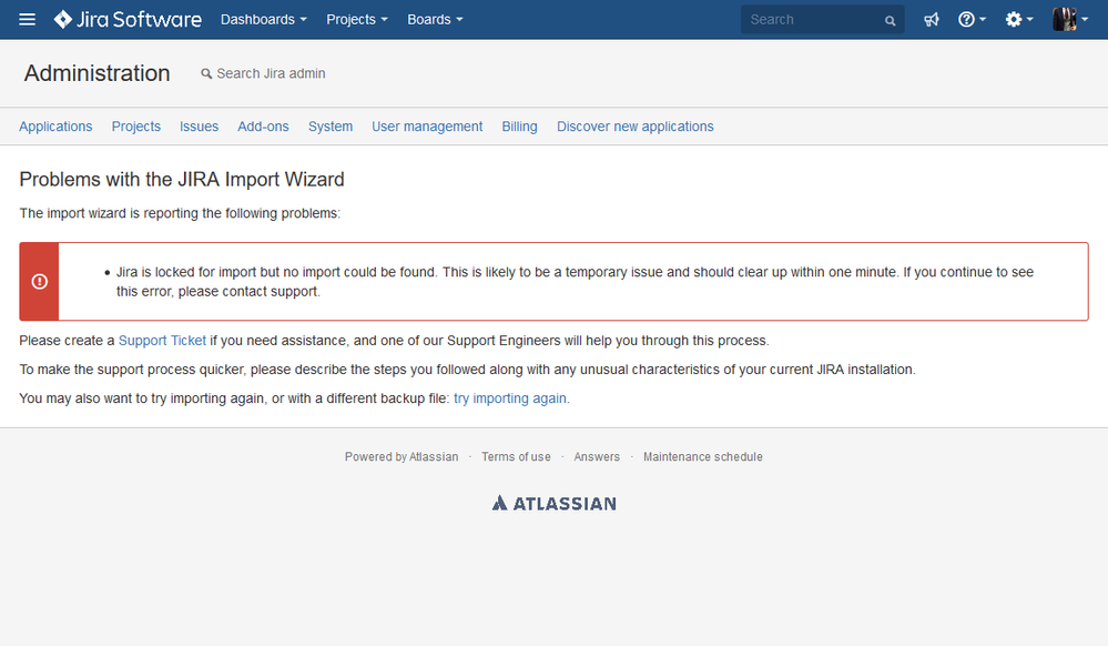

from last time i get Site Administrator (group site-admins) permissions. Restore system appeared in Jira cloud.
But!
When it starts importing after about half a minute this message appears.
http://joxi.ru/52aZM30UGYyq1A
nothing more to see after login in
http://joxi.ru/4Ak9YNwiML4Ggm

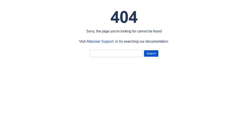

Please create a "Support Ticket" (Link not working)

Hi there,
Best to report this to the Cloud team as you were attempting to do, so they can have a look at your logs.
The correct contact form URL is: https://support.atlassian.com/contact/#/
I had tried to raise the request for you but I don't personally have your Cloud URL and was unable to find your license under your email address.
Please feel free to raise the request above or you can let me know your Cloud details.

Is that issue is solved, that we need to import the backup in JIRA Cloud which we took from the JIRA server
Shannon S
April 18, 2018
Aman,
The issue with the original reporter's export required him to edit the entities.xml file and update a few lines, and re-zip it. It will depend on what errors are occurring on the server logs. It may not be the same issue for you.
I would recommend using the contact form above and report your issue so our team can have a look at your Cloud logs.

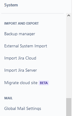

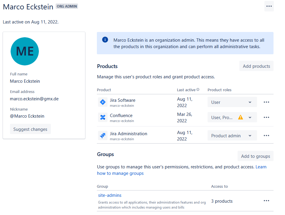

Marco Eckstein August 11, 2022
"Restore System" is missing in my Jira cloud instance even though I am site-admin:
