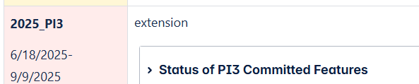

Per this article, Nested Tables are now supported in Confluence Clou... - Atlassian Community, I'm trying to nest a table within a table, but when previewing and publishing the page, I see 'extension' in place of the nested table.
How can I get the nested table to display when the page is published?

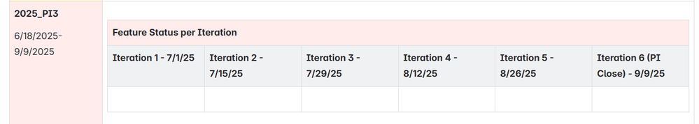

It's a table nested in a table that is nested in a Mosaic Tab.
The first image shows it in Edit mode

Have you tried publishing the tables outside of the Mosaic tab? Is the nested table then displayed?
Mosaic tabs come from a 3rd party app, and in Confluence cloud Atlassian prevents nesting of some solutions.

Adding to @Mattia _Communardo_ , Nested macros are not supported in Cloud. Especially with 3rd party apps.
There is limited support for nested macros, at the moment, for some standard Confluence macros. But not 3rd party.
https://jira.atlassian.com/browse/CONFCLOUD-70746
