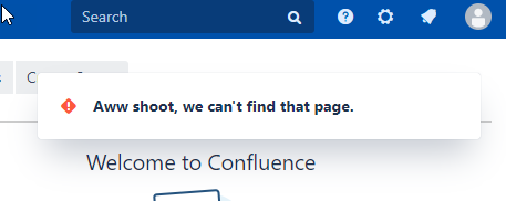

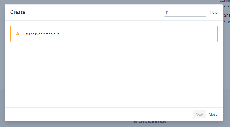

My custom URL (confluence.mycompany.com) is working, and I can log in. However, when I log in, the dashboard items such as "All Updates" section doesn't load. When I click on the "..." next to "Create" button on the top menu, a dialog opens and says "user.session.timed.out". When I look at the network tab of my Chrome, I see many 404 pages. Below are a few examples of those 404 requests.

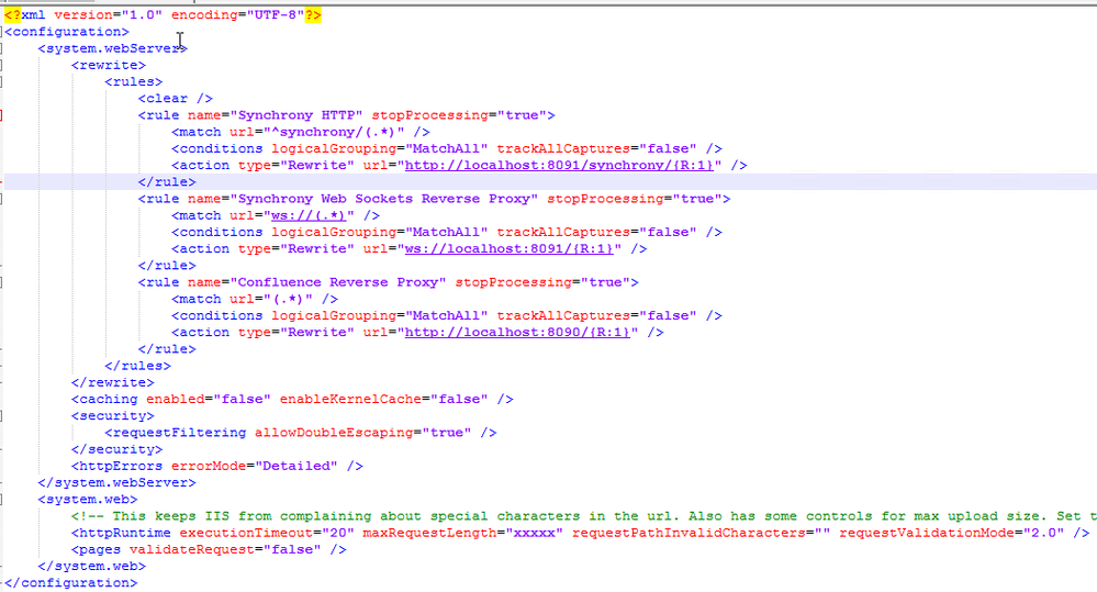

From what you shared the issue looks like it is in IIS and that the proxy is not setup properly.  Can you double check all of your IIS settings.

Here's my web.config file. Let me know if you see something.
