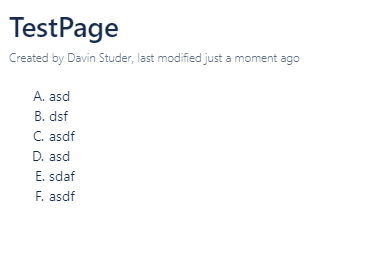

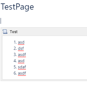

Using the macro code above that I provided it should look like this in edit mode ...
And this when the page is viewed.
