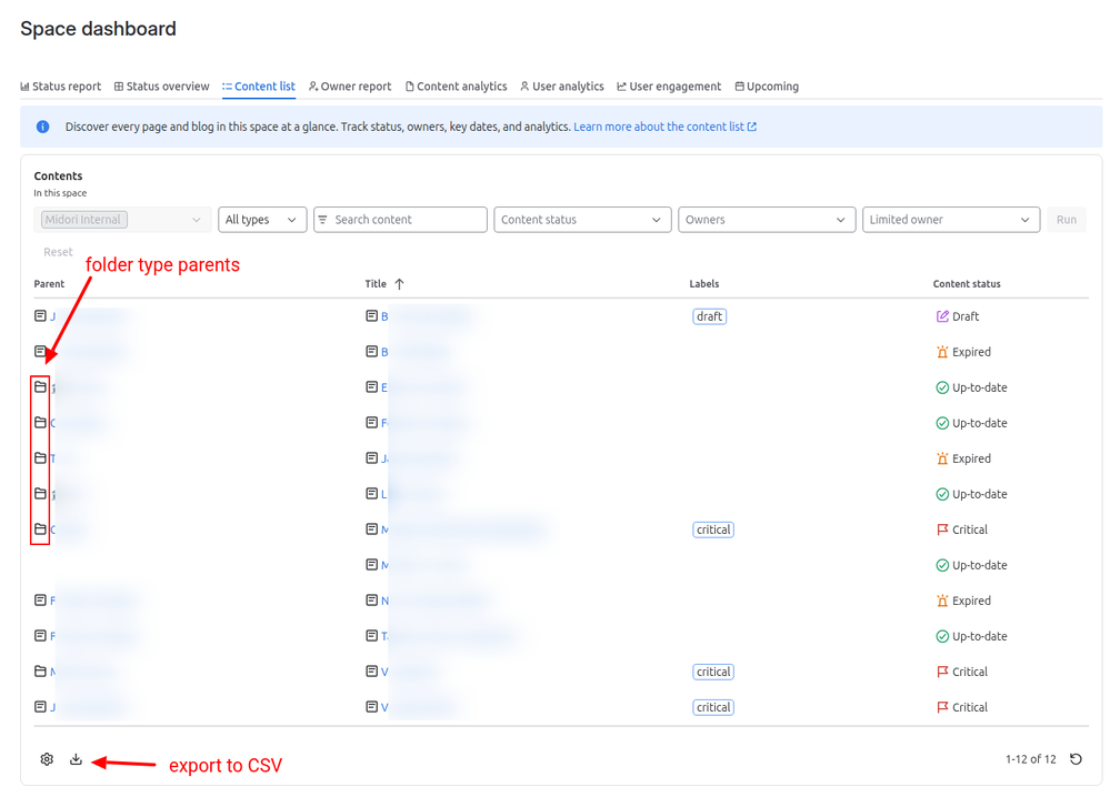

With the Better Content Archiving app, you can add the "Parent" column to all content list views. This column displays folder type parents, as well:
And when you export the list to CSV (see the icon under the list), the resulted CSV contains:
Both these columns work for folders with no difference.
(Discl. this paid and supported app is developed by our team. Free for 10 users.)
