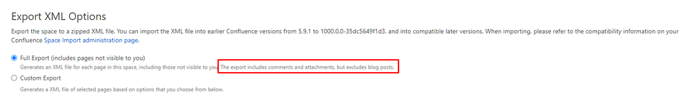

You can export a space in xlm and import it in confluence. Attachments will be saved, as well as apps data, as long as they are found on the target instance.
E.g. when you choose to export as Full XLM, there is statements about the attachments:

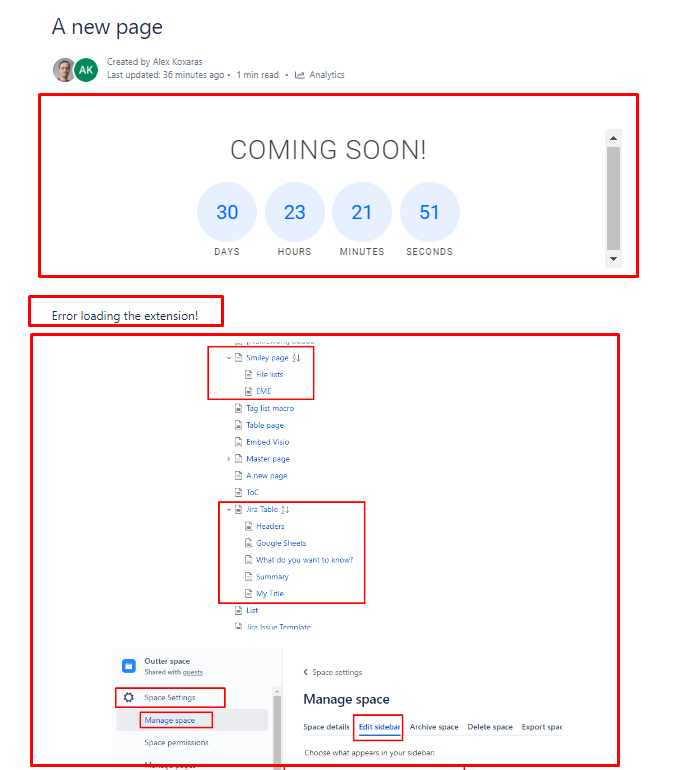

And when you import it, if you have your app installed you will see the data (rect 1).
If you don't have the app installed you will see a message (error loading the extenstion) on rect2.
And attachments (images in my case) can be seen on rect3.
