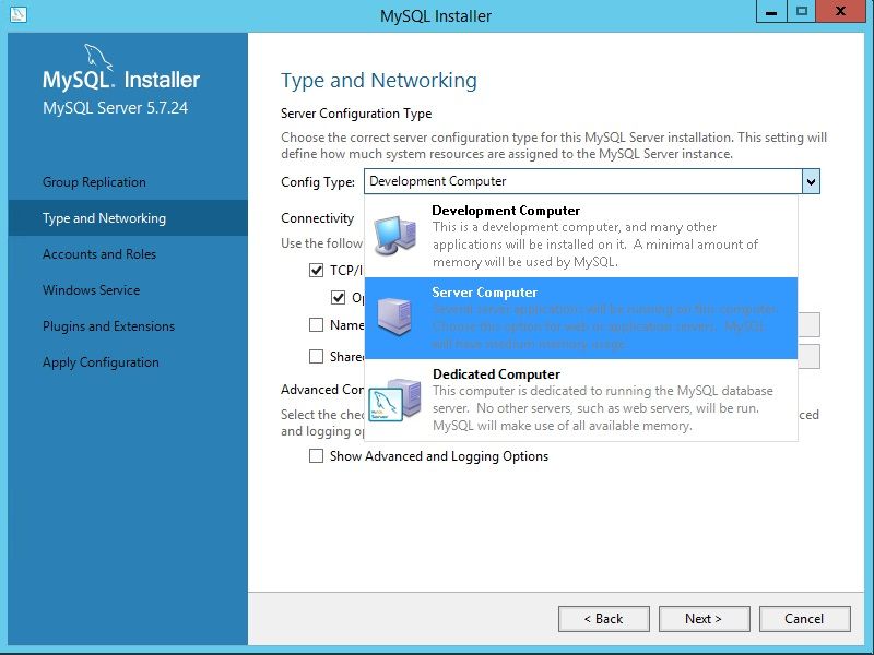

You should be good to go by setting the MySQL application as Server Computer and as Windows service as well. It should prevent the Confluence server form coming up without a database. It is a good idea to start the database before starting Confluence.

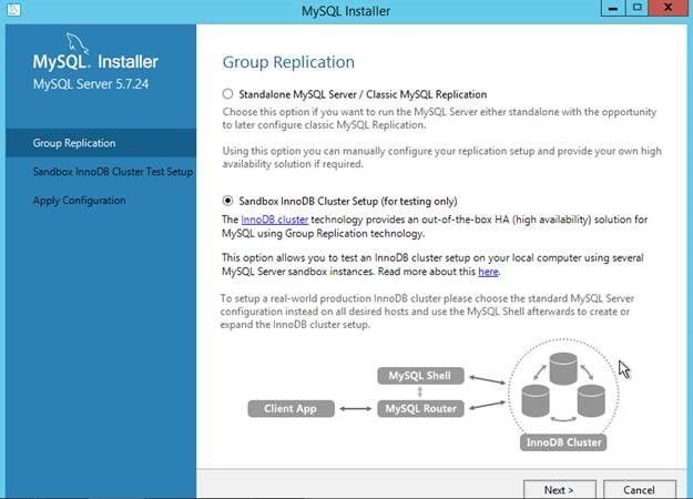

Here are the MySQL 5.7.24 first couple of setup screens…
Let me know what I should choose

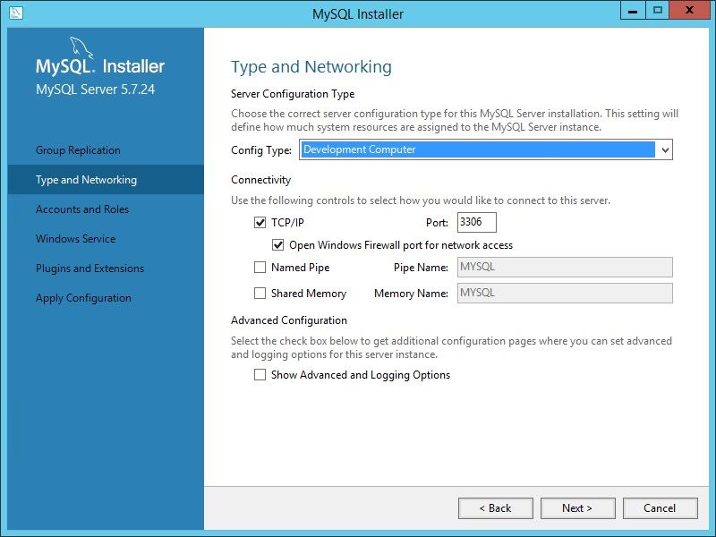

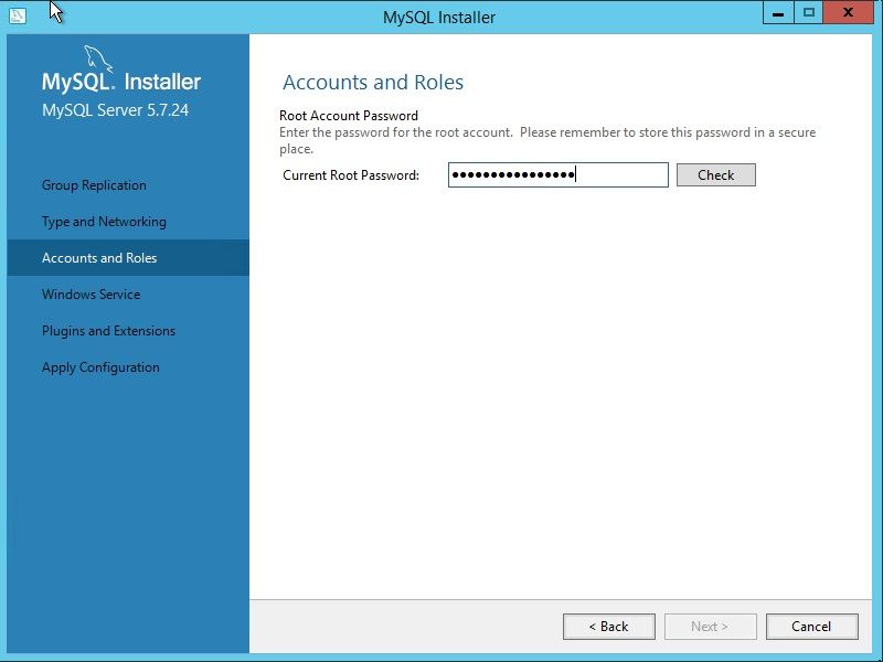

 If I choose StandAlone MySQL / Classic MySQL Replication I have the following options:
If I choose this option, I need to choose a config type. This would be Server I believe. Click Next.
I enter the root password on the next screen. Click Check and then next.

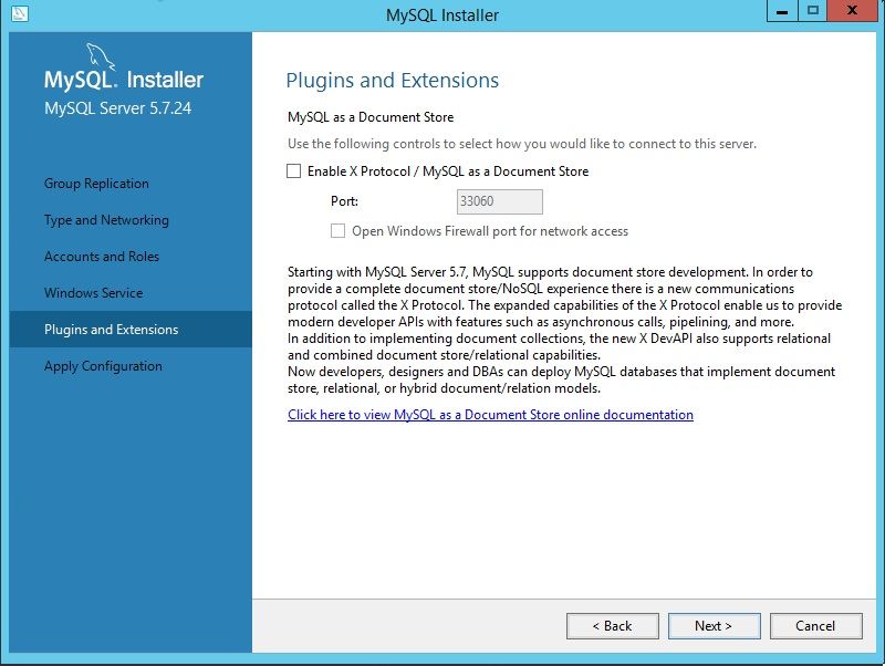

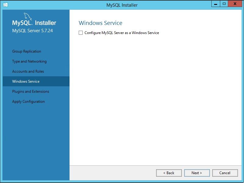

In the Windows Service window I'm given the option to configure mysql to run as a service. I leave the default and lick next.
On the Plugins and extensions screen, do I leave the default and click Next?

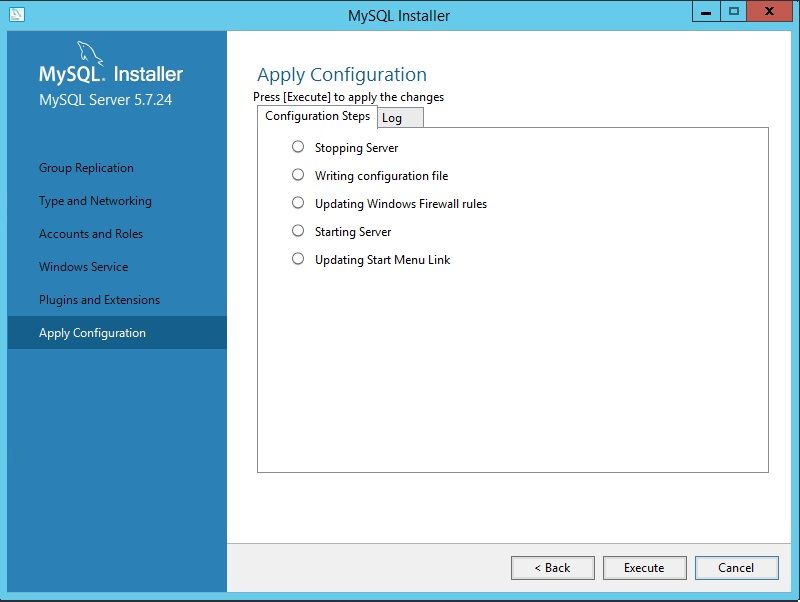

The screen that follows is simply to execute the setup.

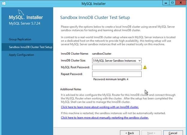

If I choose the Sandbox InnoDB Cluster Setup (for testing only) route from the main setup screen, I get these options:
What Cluster size do I use? Plus it specifically states “TEST”, which we’re not running. This is production.
In the Windows Service window I'm given the option to configure mysql to run as a service. I leave the default and click next.
