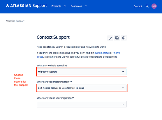

Maren
September 16, 2019
Hi Jeremy,
Apologies for that, not sure why the link's not working.
Just use our standard support link, and then to make sure it gets to our migration support team quickly, select "Migration support" in the first dropdown.
Here's that link again just in case: https://support.atlassian.com/contact/#/
Cheers,
