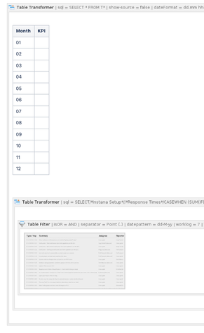

Hi all,
im struggling to create a merge 2 tables where 1 of them is a result of a table transformer macro with the goal of getting automatic updates and avoid any manual intervention. See below the case:
1. Fixed table
2. Macro table ("KPI" data)

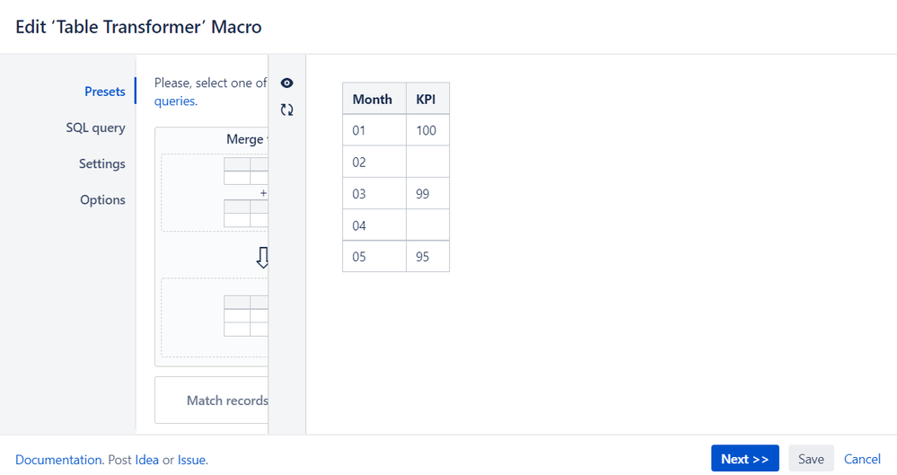

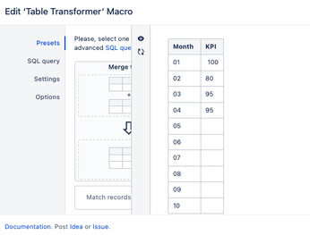

I've tried adding both tables to a new table transformer macro where do the merge (using default SQL config), this is the actual result:

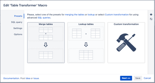

These two tables can't be merged together in a proper way. The first Merge preset that you choose merges the tables with similar headers:
|Col 1 |Col 2 |
|A       |12     |
|B       |14     |

I've modified the macro SQL to generate same header as the fixed table
Tried adding an additional macro for month 02 and set the following SQL on the main table transformer
SELECT
FROM  T1 JOIN T2 ON T1.'Month' = T2.'Month'
Result
so it's working for 1 table but I would need to tune the SQL to map T1.'Month' to each 'Month' column from the additional 11 tables... any hint on how to modify above SQL to do something like "FROM  T1 JOIN T* ON T1.'Month' = T*.'Month'"?

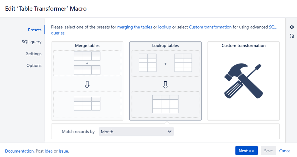

It seems that the case is more simple - don't change anything in the SQL query and just choose the Look Up preset.
Here is my example with one stable table (and it doesn't require the KPI column, the Month column is enough) and three mini-tables (let's pretend that they are generated by other internal Table Transformers):

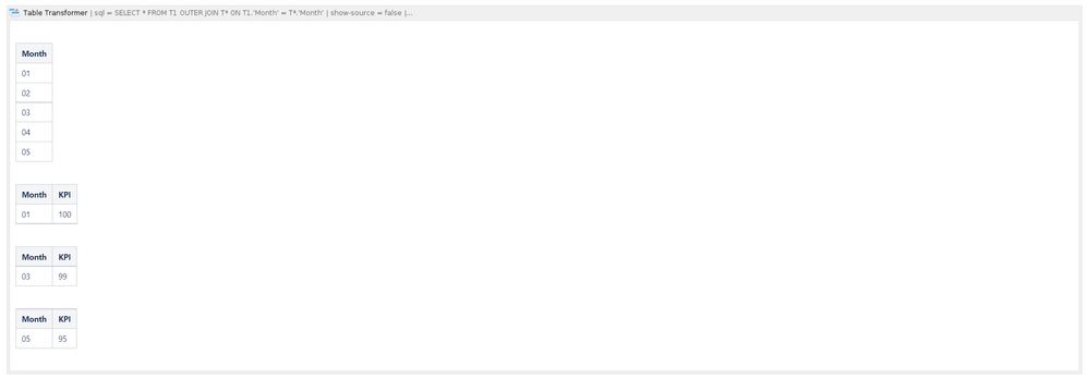

Then I choose the Look Up preset and the common Month column is shown for me to choose by default:
And here is the result:
Like Esteban Borja Lopez likes this

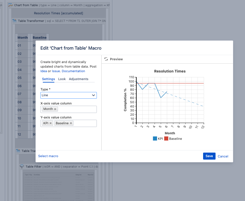

It worked like a charm:
And as for my final goal as well:
So all working as desired and no manual work other than initial config.
You rock @Katerina Kovriga _Stiltsoft_ :)
