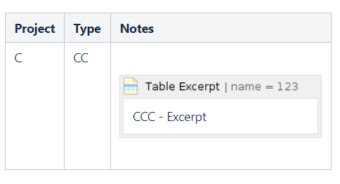

Here is your 3rd level page:
The "CCC - Excerpt" information will be reused further.

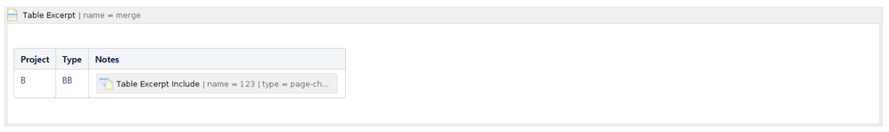

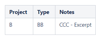

Here is your 2nd level page with a table where "CCC - Excerpt" is reused:

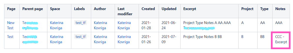

Here is your 1st level page with the summary report combined by the Table Excerpt Include macro:
As you can see, the "CCC - Excerpt" from the 3rd level page is still visible.

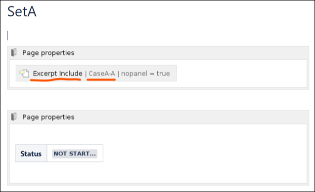

It seems more trial-and-error are required if I understand correctly :) Meanwhile I also captured my screen to show what I did in more detail. Any advice is more than welcome. Thanks for the helps.
This is the results of “page properties report” shown in the 1st-level page. “Score” of “SetA” is missing.
This is the 2nd-level page “SetA”, in which “Score” is “excerpt include” from the 3rd-level page “CaseA-A”.

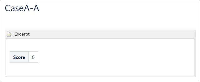

In the 3rd-level page “CaseA-A”, “Score” is equal to 0. However this is not shown in “page properties report” in the 1st-level page.

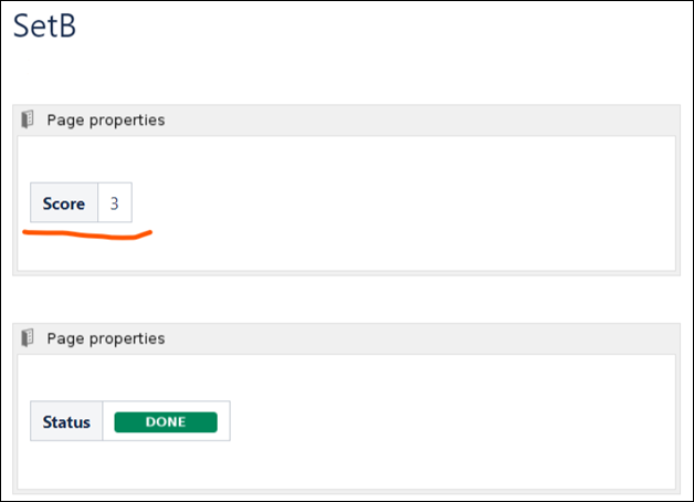

On the other hand in another 2nd-level page “SetB”, “Score” value is correctly shown in the 1st-level page.
