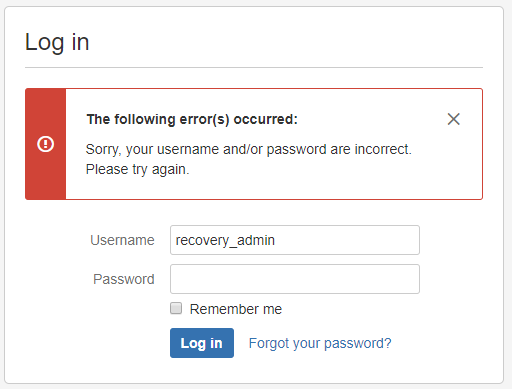

Hi Ann,
Thank you for your response. I have tried the enabling the recovery mode just as the instructions describe but I am still unable to log in.
This is what my setenv.sh file looks like.
CATALINA_OPTS="-XX:-PrintGCDetails -XX:+PrintGCDateStamps -XX:-PrintTenuringDistribution ${CATALINA_OPTS}"
CATALINA_OPTS="-Xloggc:$LOGBASEABS/logs/gc-`date +%F_%H-%M-%S`.log -XX:+UseGCLogFileRotation -XX:NumberOfGCLogFiles=5 -XX:GCLogFileSize=2M ${CATALINA_OPTS}"
CATALINA_OPTS="-XX:G1ReservePercent=20 ${CATALINA_OPTS}"
CATALINA_OPTS="-Djava.awt.headless=true ${CATALINA_OPTS}"
CATALINA_OPTS="-Datlassian.plugins.enable.wait=300 ${CATALINA_OPTS}"
CATALINA_OPTS="-Xms1024m -Xmx1024m -XX:+UseG1GC ${CATALINA_OPTS}"
CATALINA_OPTS="-Dsynchrony.enable.xhr.fallback=true ${CATALINA_OPTS}"
CATALINA_OPTS="-Dorg.apache.tomcat.websocket.DEFAULT_BUFFER_SIZE=32768 ${CATALINA_OPTS}"
CATALINA_OPTS="-Datlassian.recovery.password=passw0rd123 ${CATALINA_OPTS}"
CATALINA_OPTS="${START_CONFLUENCE_JAVA_OPTS} ${CATALINA_OPTS}"
CATALINA_OPTS="-Dconfluence.context.path=${CONFLUENCE_CONTEXT_PATH} ${CATALINA_OPTS}"
CATALINA_OPTS="-Dpassword.confirmation.disabled=true ${CATALINA_OPTS}"
AnnWorley
January 22, 2018
That looks correct but the recovery mode is a new feature of Confluence versions higher than 6.5.0. If you are using an older version you will need to use SQL queries as described in Restore Passwords To Recover Admin User Rights
To check your version, search the <confluence_home>/logs/atlassian-confluence.log for the phrase, "Starting Confluence". The startup entry will include the version of Confluence.
If there is a custom authenticator in <confluence_install>/confluence/WEB-INF/classes/seraph-config.xml that is used by the SSO plugin, please comment it out and comment in:
<authenticator class="com.atlassian.confluence.user.ConfluenceAuthenticator"/>
Confluence will need to be restarted to pick up changes to configuration files or the database.
Jefferson Dong
January 23, 2018
Going the SQL route worked. I was able to enable and reset the admin password. Thank you for your help!
