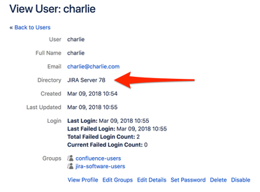

I am glad there are only a few users in the internal Confluence directory that need to be migrated to the Jira external directory because there is no way to migrate users between the two directories. If you create them in Jira with the same user names Confluence will "see" them as the same users and associate their content (avatar, personal space, etc) with them. There is no way to migrate the paswords
Setting the Jira user directory in Confluence to read/write will allow you to make changes to that user directory from either application but will not sync users from the Confluence internal directory to the Jira external user directory.
I do not recommend deleting any users from the internal Confluence directory until you have verified that their Jira accounts are working as expected. To make sure the user that is logged in is the one from the Jira user directory, you may check the user directory displayed in User Management in Confluence:

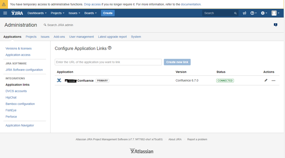

Hi Michael,
To use Jira to manage Confluence users, Confluence has to be set up in Jira under Jira User server as in your screen shot then Confluence has to have a User Directory set up to sync users from Jira. Detailed instructions are on this page you linked: Connecting to Crowd or Jira for User Management
Users in the Confluence Internal directory will not be synchronized to Jira, but they can still access Confluence. Managing Multiple Directories has a lot of good information.
Application Links are not related to user management.

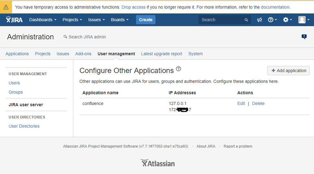

My bad, the following is the screen I was asking for:
Hi Michael,
Can you please send a screenshot from your Application Link under JIRA?
Do you mean from Applications->Application Links?
(There is nothing there)
Or from User Management->JIRA user server? (Configure other Applications)
127.0.0.1 would be the Jira server, the 172.x IP is confluence.

Ok, so I followed the instructions here to make the link in Jira, but Jira still doesn't see the Confluence made users in Jira user management. I tried making the link both ways from Jira, with and without the checkbox "The servers have the same set of users and usernames".
