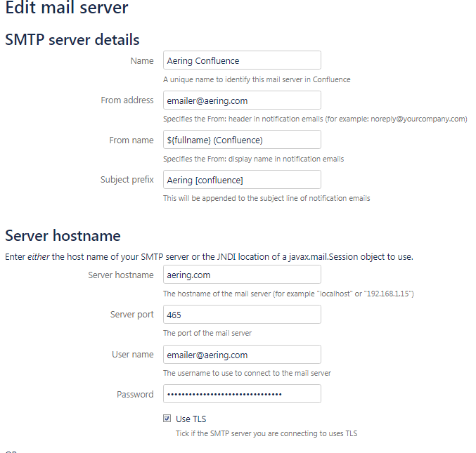

Hi,
Mail server isn't working,
I have below settings
Then tried to test the email but got the error as in the logs below.

solved
Thank you very much @Yogesh Mude
evidently, confluence can only use port 587

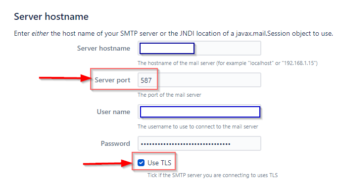

Alexey Studitsky
September 2, 2022
So, to sum up, all you need is to change 465 to 587 port and mark Use TLS checkbox:
