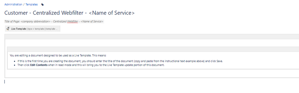

Think Technologies Group July 22, 2019
Hi! Sorry for the slow response. I didn't get an email that this was answered. See above. If I add a new macro, the name appears int he title bar of the macro, but for all existing, they are blank.

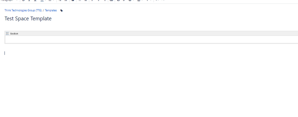

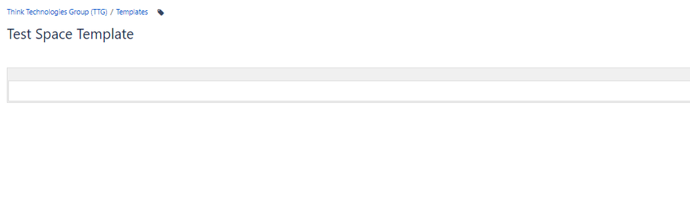

Think Technologies Group August 26, 2019
Hi Shannon,
I double checked and all plugins were disabled in safe mode. As for macros on regular pages, I haven't found any issues, just in the global templates. I just tested a space template and it definitely does it there as well!
Test space template after putting a section macro and hitting save and then going back to edit the template:
Test space template after putting a section macro and hitting save and then going back to edit the template and then hitting edit on the macro and save again (this makes the title for that single macro show up)

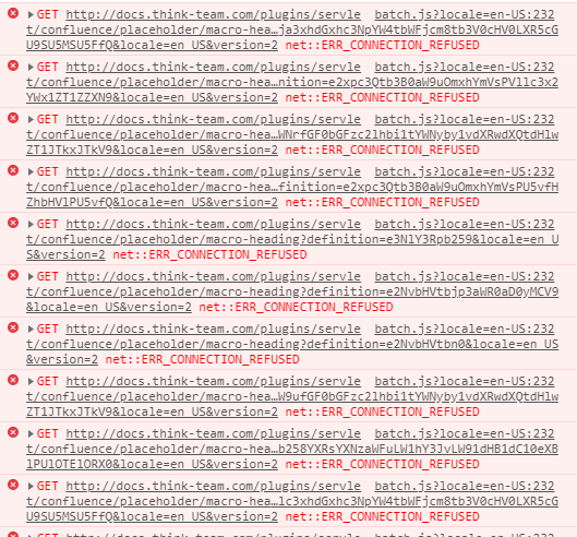

Thank you for sharing that information. I'm still not able to replicate this myself, but I believe it's possible you could be running into this bug:
  • CONFSERVER-57934 Adding panel,excerpt,warning,note,tip or info macro to the page in edit mode will trigger mixed content action in browser
In this case, the problem is only with certain macros. I'd like to test if this is what is affecting you.
  1. The behavior will change across various browsers, but the main issue is that http is being used in requests when it should be https.
  2. To test this, I recommend recording a HAR file of the page load, and then have a look at your HAR file to see if you see any http requests.
Could you give that a try and let me know what you find out?
Regards,
Shannon
Think Technologies Group September 3, 2019
Hi Shannon,
I started the har recording and found that there were a bunch of errors with something reaching out to the HTTP part of the page. I'm not sure what to do to resolve it though.
