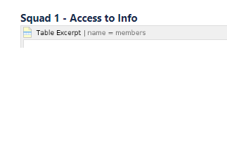

I cant share the rest of the table due to confidentiality.  This is the macro I used macro.png

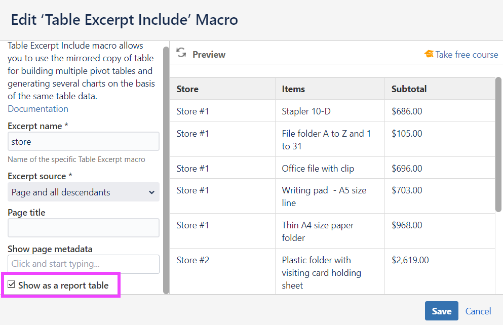

Go to the Table Excerpt Include macro and check if the "Show as a report table" is ticked:
If there are no any typos/extra columns in the header row, your separate tables will be merged into one big report.
If you don't see the option, it means that your version of the app is old and you need to ask your Confluence administrator to update it (the current version is 9.3.0).

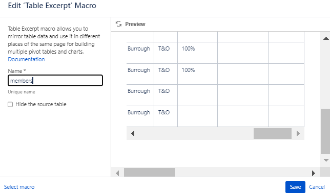

This is what I see

You went to the settings of the Table Excerpt macro.
And you need to go to the Table Excerpt Include macro - the one that you use on your master page to collect several tables into one big report.

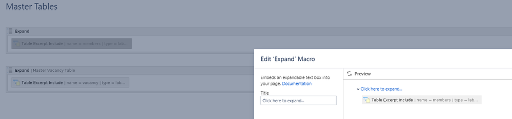

Katerina Kovriga _Stiltsoft_
September 21, 2022
From your screenshot I see that you use two Table Excerpt Include macros: one for the "members" Table Excerpt and the second for the "vacancy" Table Excerpt.
If you want to combine several Table Excerpt Include macros (not the tables inside one Table Excerpt Include, but outputs of several different macros), wrap them both into the Table Transformer macro and choose the "merge" preset.
