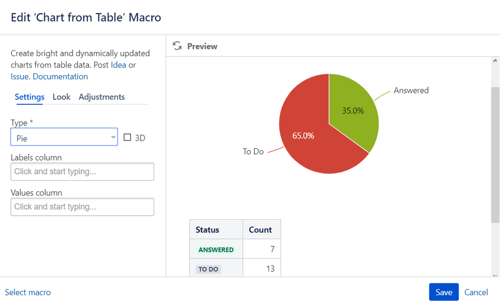

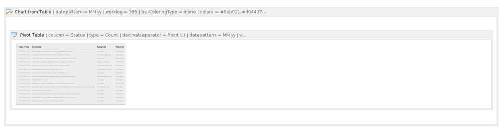

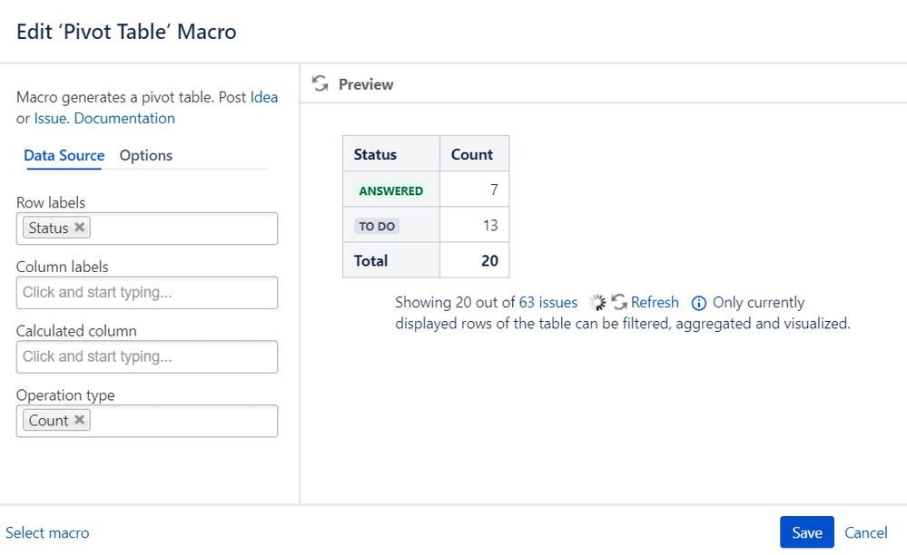

Wrap your Page Properties Report or Jira Issues macro in the Pivot Table macro to count the number of different statuses and then add the Chart from Table macro to show the required percentage.

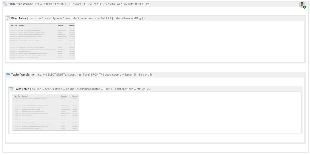

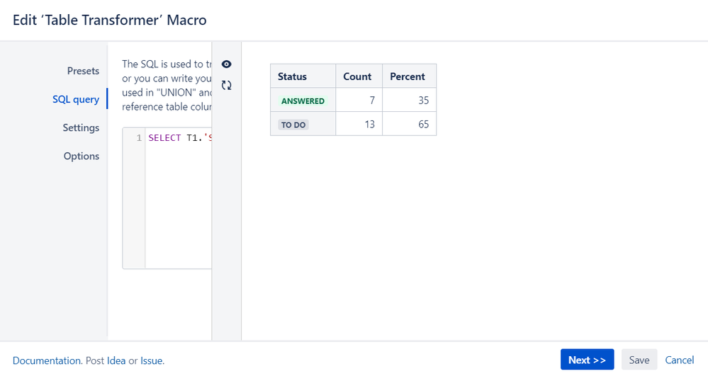

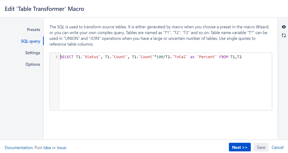

Swarna 1.pngSwarna 2.pngSwarna 3.pngIf you want to calculate percentage or any other things within your table cells, use the Table Transformer macro.
Swarna 4.pngSwarna 5.pngSwarna 6.pngThese examples were done just for your case and it took me less than 5 minutes. But our app allows you to create much more complex visualized dashboards based on Jira Issues macro, Page Properties Report macro and plain tables as well.
