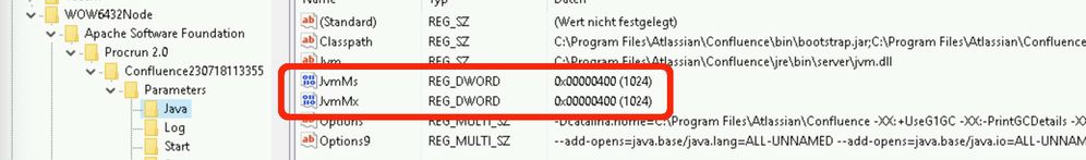

  1. You might want to consider increasing the highlighted values for Confluence's heap (from your screenshot). I haven't encountered a lot of instances lately that have run smoothly with the default 1GB and any amount of user-installed plugins. You mentioned that the VM has 8GB, so if Confluence is the only thing installed/running on this box, you hopefully have plenty of breathing room to allocate some more RAM. Depending on the amount of users you see concurrently, I might suggest increasing both values to 2048 (2GB) and going from there.
