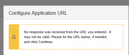

When linking applications (in Confluence I clicked -> General configuration -> Application link -> and added  https://mycompany.com after clicking creating I get an error as shown:

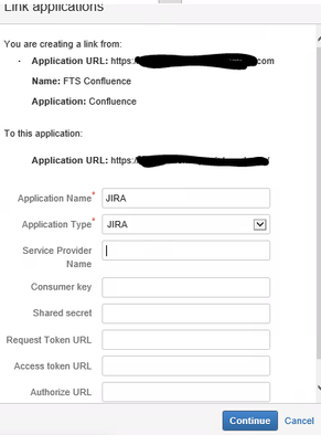

If I click continue it asks for additional details:

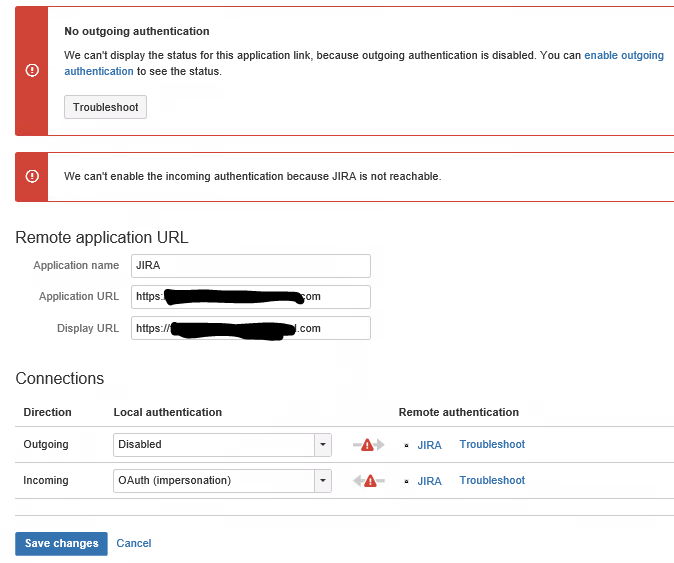

If I click continue I get a link created with a error and if I click edit I get this error:
Not sure why JIRA is not reachable because I can ping the host fine. This is what my server.xml file looks like:

Sorry you're having some trouble getting applinks set up! From the looks of things, I'd actually recommend using a reverse proxy instead of trying to serve HTTPS directly from Tomcat. Since you're on Windows, the common reverse proxies we see are IIS (should work easily with the PFX certificate you already have), Apache, and nginx now even has a mainline branch build for Windows.
The instructions should help you reconfigure the connector in your server.xml file in addition to configuring your reverse proxy itself. Don't forget to double-check the base URLs in your applications to make sure they are https and have the right addresses. Restart your applications after making changes in server.xml and the proxy.
I think that will mostly get you where you need to be - we do see a lot of issues with trust in the internal keychain and terminating SSL at a reverse proxy is the best way to clear those up.
