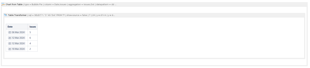

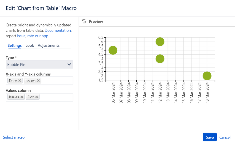

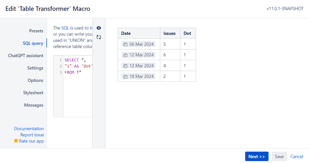

As a workaround, you may use the Bubble Chart type:
SELECT *,
"1" AS 'Dot'
FROM T*
Now as we draw real dots and not a dotted line, you can have several separate numbers to be reflected under the same date.

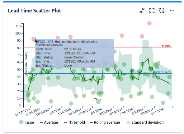

You best option here would be our Great Gadgets app. It offers a Cycle Time Control Chart gadget that you can easily configure to display the Lead Time Scatter Plot that you are looking for. And everything will be in real time, without any manual work. The gadget can be used in both Jira and Confluence.
All you have to do is to configure it to use the filter or the board that returns the issues of your team, then to measure lead time (from issue creation to done) and eventually to set a threshold for highlighting the issues that took longer than expected (the ones in red-color).
It can also display a Data tab with a detailed report about the issues, which you can easily export in CSV:
The Data tab showing the issues along with their cycle time
See here this gadget in action along with Lead Time Histogram and Cycle Time Trend gadgets, which you might find also useful: https://community.atlassian.com/t5/Jira-Software-articles/Building-a-powerful-Kanban-dashboard-in-Jira-with-Great-Gadgets/ba-p/1664331
