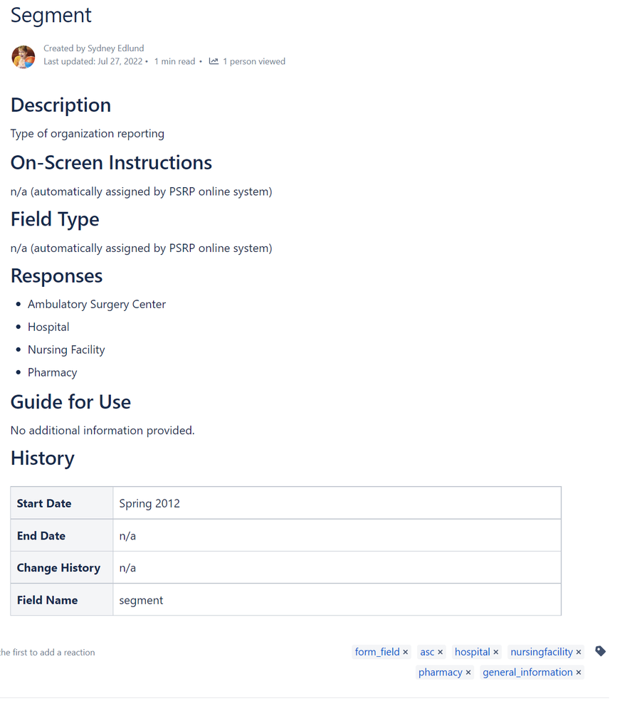

In the first picture, you can see an example page that is fine, the labels in the bottom corner show up as they should.

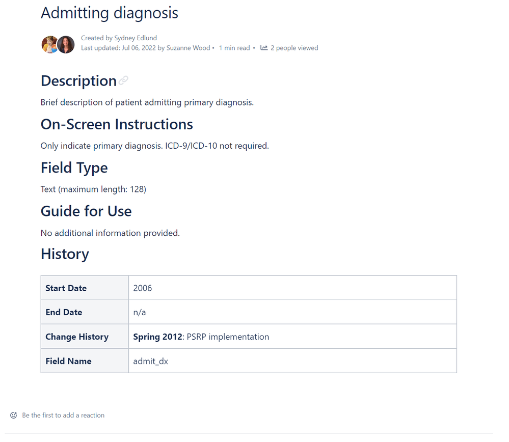

In the second picture, you can see an example page where the labels corner is just blank. Not even an icon to click on to add labels.

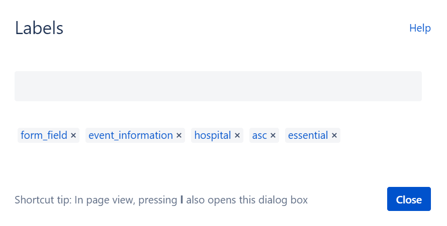

But if I edit the page and choose "add labels" from the top right corner menu, I can see that this page does have labels (picture 3). When I publish, the bottom right corner is empty.
