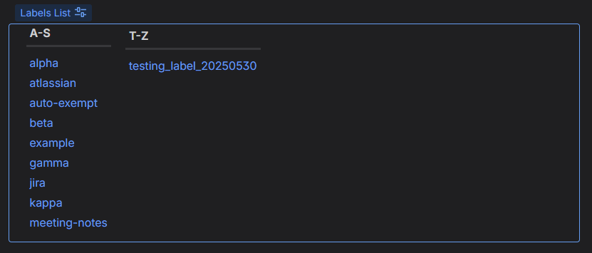

Hey @Stefan Fuerstenhoefer ,
If you'd like something like Labels list but only for a specific parent page and its sub-pages, there isn't a straightforward way to get that 🫤
We haven't found any open suggestions for having additional filters for this macro, so it might be worth checking with Atlassian Support if they could create a new feature request 👀
What would definitelly work is having a custom solution that works via REST API, but that, as Kris said, might be a bit complicated.
What you or your admin could try (if you have AI enabled), is this new Studio feature that actually builds an app for you based on your requirements: Build custom Forge apps in Rovo Studio - no code required!
Now, it's far from ideal, and the feature is still in beta, but basically, we're talking about having the ability to build custom solutions quite easily if an out-of-the-box solution doesn't exist.
Anyway, it might be worth checking out 🤔

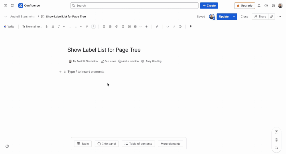

Hi, @Stefan Fuerstenhoefer,
This can be achieved using a custom user macro.
While testing our app, I was able to create what I believe is the result you're aiming for, and I've prepared a ready-to-use template for it. The solution can also be further customized and adjusted to match your exact requirements (within the limitations of Confluence Cloud).
If you'd like, I'd be happy to help further — just let me know.
